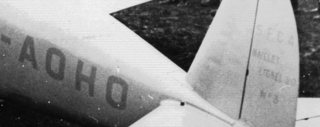

  • Maillet 302 (193?): second ML.20 in tourism airplane configuration: F-AOHO (n° 3).
I never heard about such designation. The F-AOHO had a very short life, as it was used just after its manufacturing for a raid where it was destroyed in a tragic accident. The only designation assigned to it was Maillet-Lignel 20 c/n 3, as written in its tail.

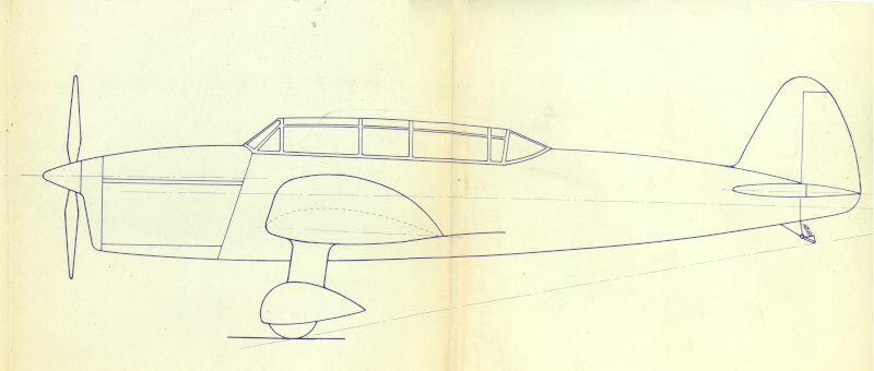

  • Lignel 32 (1939): unknown variant tested in the ONERA wind tunnel.
The Lignel 32 was announced by SFCA as record breaker aircraft at the 16th "Salon de l'Aviation" in Paris' Grand-Palais in 1938.

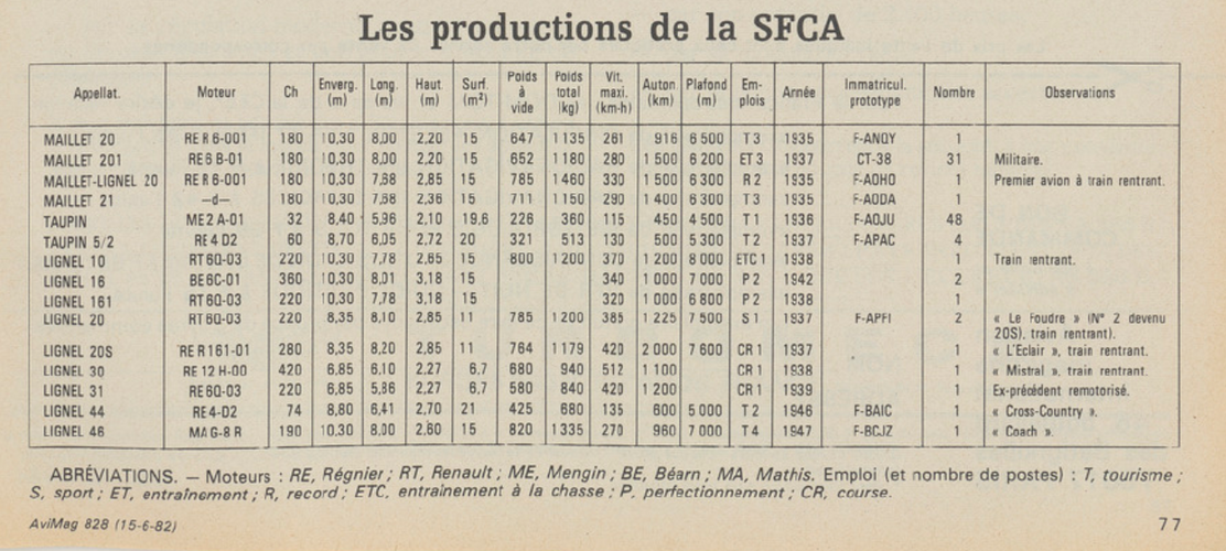

  • Lignel 16 (160) (193?): development of the Maillet 202 trainer, engine unknown. Not built.
  • Lignel 161 (1938): two-seat combat trainer low-wing monoplane prototype with a 220 hp Renault 6Q-03 engine. One built.
  • Lignel 16 P2 (1942): two-seat combat trainer low-wing monoplane prototype with a 360 hp Béarn 6C-01 engine. Two built.
This is not in line with the information I found. Lignel had presented its Lignel 16 to competition examination commission for P2 technical specification A38 in 1938. French State then placed the order number 1878/8 for 2 copies. Both were built and tested in April 1940. The second one became the Lignel 161.
From Aviation magazine 1982.

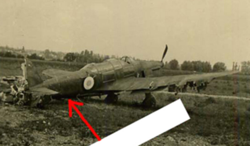

  • Maillet 205 ET2 (193?): variant with double-controls and raised cockpit; not proceeded with.
I am not completely sure about this.
There is a strange photo, sold many years ago on ebay, showing an abandonned French two-seat plane, which really looks like a Maillet 201, but with the cockpit windows over-elevated. Compared with an original blue print of the Maillet 205, they really look similars.
For me, this photo shows a modification applied to the Maillet 201 s/n 4, to serve as prototype for the Maillet 205.
