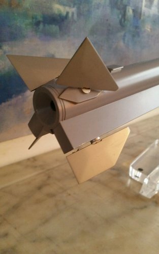

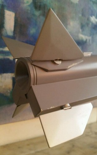

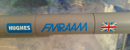

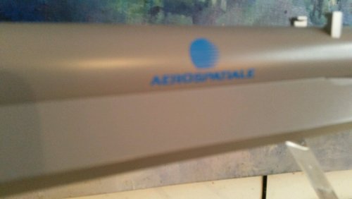

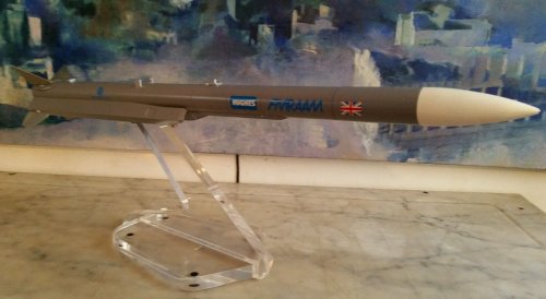

1995 FMRAAM model
http://www.ebay.com/itm/1995-LARGE-Desk-Model-MISSILE-FMRAAM-HUGHES-aerospatiale-maquette-topping-mee/301896972069

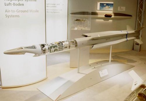

Not sure if this fits here, but there is already a bunch of ARMIGER stuff here and no other fitting thread. I found this picture of a model on the German-Dutch Wind Tunnel website. It looks like ARMIGER with the dolphin-nose seeker and the 4 air-intakes. Also the file name has "sead" in it. Does anyone know if the main rocket bodys diameter was the same as on the Meteor? Would the dual-mode seeker fit on a Meteor?

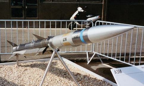

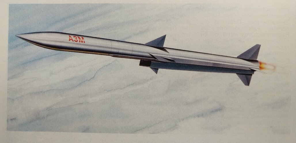

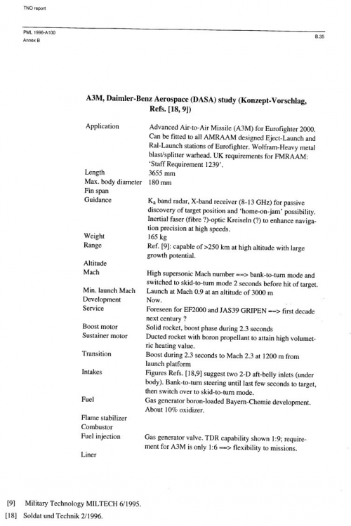

On the same site there is also a picture of an A3M the German proposal for the Meteor, that later merged with the French and British-Swedish proposals. The only major external difference to the Meteor i can recognize, are the small wings near the engine intakes. The second picture is from somewhere else as a reference.

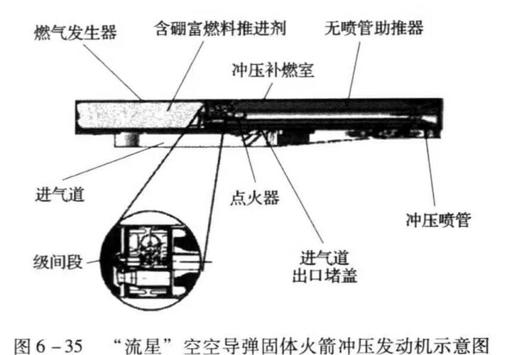

No idea how chinese get those meteor's information at the time earlier than 2010
