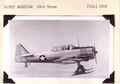

This photo shows a Texan on skis, but is it the same?
Thanks Skyblazer, but I'm not sure that is an SNJ. Those look very similar to snow skiis developed by Noorduyn in Canada for the RCAF Harvards. I expect the SNJ project may have been a water ditching aid.

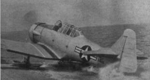

From Flight:
http://www.flightglobal.com/FlightPDFArchive/1952/1952%20-%203458.PDF
http://www.flightglobal.com/FlightPDFArchive/1952/1952%20-%203459.PDF
I don't know if it is subject to copyright by Flight, but here is the pic from the 1952 Flight article. Not crash hot, but interesting.
My understanding of the SNJ program is that is was intended for two purposes: collect basic information of surface skimming hydrofoils at low cost and technical risk; and to evaluate the feasibility of operating such an aircraft from a beach, without a buoyant hull. The theory was that you accelerated/decelerated on the beach, only being on the water if you were going fast enough to produce the required hydrodynamic lift. As this video shows, the theory has only limited application today, with some obvious drawbacks.
