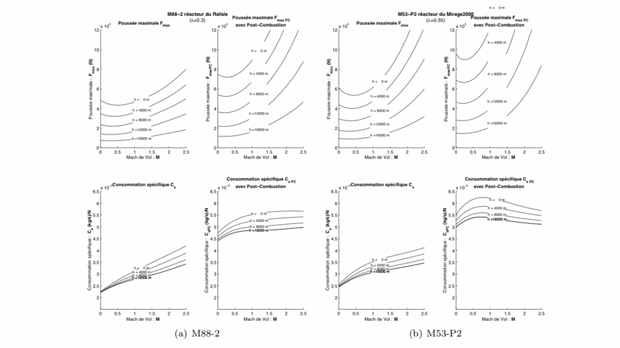

All I know of M88-1 seems to have been the dev model. M88-2 was used from the first 1989 run, 1990 installation on the Rafale A and installation on the four prototypes but still not considered the “final” engine which was done by 1996. I guess E1-4 are developments of the m88-2?
1990 timeline
According to German wiki the UAE was interested in the M88-3 but French wiki mentions issues with center of gravity as of 2010.
Apparently the M88-1 was originally a lower thrust engine for early 80s EFA requirements. It was worked on for four years before being superseded by the more powerful M88-2 which was considered necessary in its own right. This is the first time I’ve been made aware the M88-1 was a design for a production engine in its own right. https://web.archive.org/web/2014101...bal.com/pdfarchive/view/1986/1986 - 0630.html
It still wasn’t expected for the Rafale A but it might have been ready earlier
But Isn't that a thesis on a modeling law for engine performance?
It’s apparently accurate though. The M53 data was used by Razbam for their mirage 2000 simulator and had it verified by the French Air Force as accurate. Presumably the same could be said about the M88.
Shouldnt those be installed thrusts? With part of the envelope (say beyond mach 2) being simulated, theoretical, with some other inlets?
Otherwise i dont know how one would get variable speed and altitude numbers if it was uninstalled thrust?
F119 doc corrected me on another forum. I was originally told otherwise and was parroting what I was told. But it does seem to make more sense installed.
