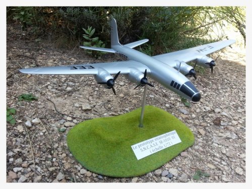

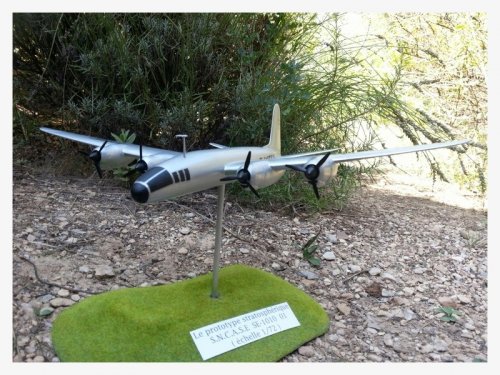

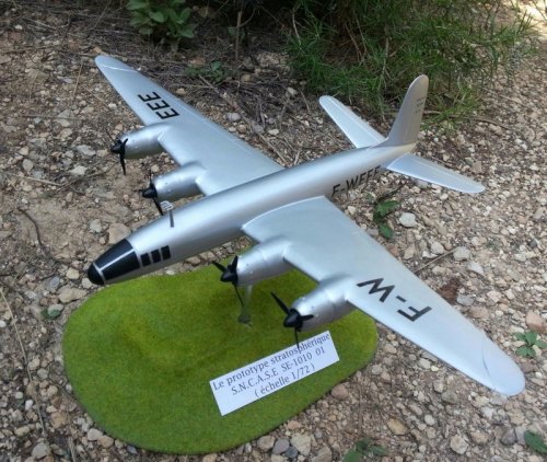

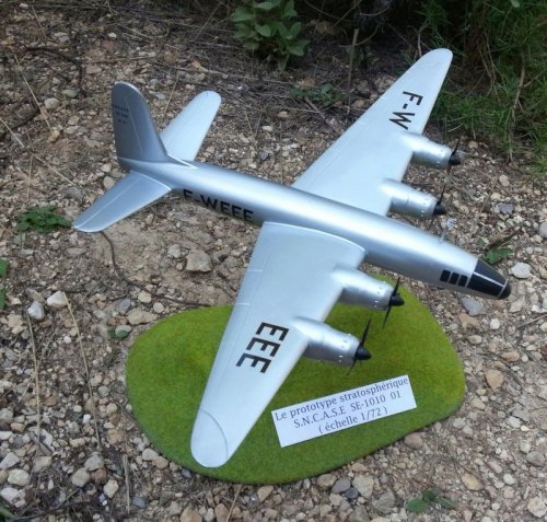

nice bird ! the real one was to be France very own Republic Rainbow long range reco aircraft but was actually a bitch that went into a flat spin and killed its entire crew in 1949...

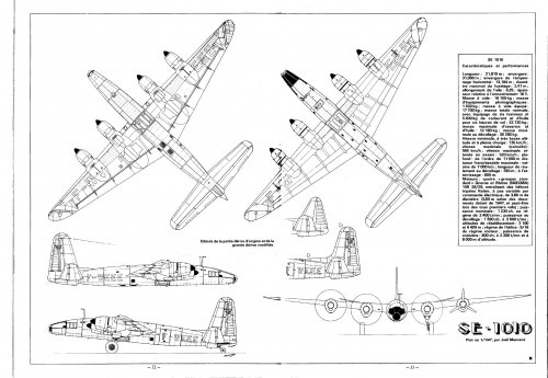

I have somewhere a good plan of the SE 1010 in an FANA of August 1987, I think ... In the meantime, I put you one of the tracks of the SE 2010 taken from the excellent work of Laurent GRUZ "SE 2010 Le Géant oublié" so that everyone has an idea of the crazy French ambitions in air transport. Even the P & W R-4360 (3500 hp in Civilian power!) lacked power to give this aircraft a truly transatlantic capability with an acceptable commercial load !

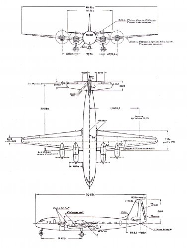

A few weeks ago I tried to see for an electric model of the SE-1010. My conclusion was that the wing was too rejuvenated at the end and I had considered increasing the wing chord to secure the stall. The horizontal stabilizer, on the other hand, appeared to me to be usable as is ... But let us admit that this betrays a little the lines of the beast !View attachment SE 1010 VUE EN PLAN.jpg
