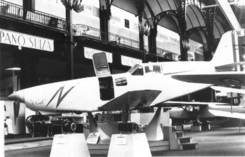

Many projects or concepts are very short lived. Often they were
shown as models or mock-ups to an astonished public on airshows,
like Farnborough or Le Bourget, just to be forgotten some time
later. Just as an example, I’ve attached a photo of the SNCAC
800, a very nice looking, fighter like shaped small transport for
four passengers. This photo was shown on the aeroforum last
year. My question : As photo cameras were standard equipment
long before the war, collections of photos from airshows probably
exist and should be a phantastic source for now unknown projects,
if they don’t show only the flying hardware outside the halls .
The only problem, where to find such collections ? Maybe there
even were official photographers, taking photos of every stand
in the halls ? Who knows a site, showing the exhibits of the
Aerosalon Paris all the years ? Were there illustrated catalogues ?
If so, where to get them ??

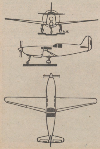

Mockup displayed at the 1946 Paris Airshow. Sorry that the quality is not better.

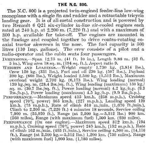

Illustration NC 800_001 from The Aeroplane Spotter December 14th 1946.
Text block NC 800_002 from Flight November 21st 1946.
Regards Bailey.

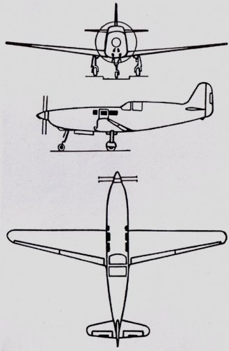

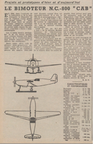

From a "Der Flieger " of the 60' :

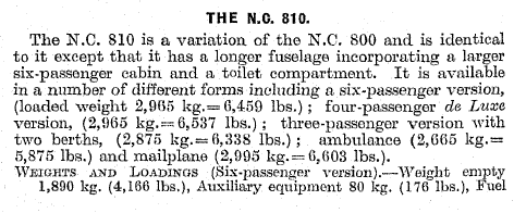

there was a larger version with 6 passengers,the SNCAC NC.810.

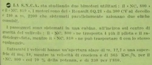

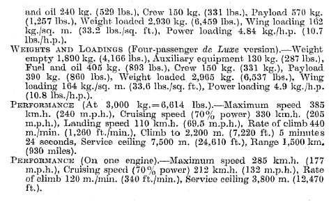

From JAWA 1947, a more Info about NC.800 & NC.810.
