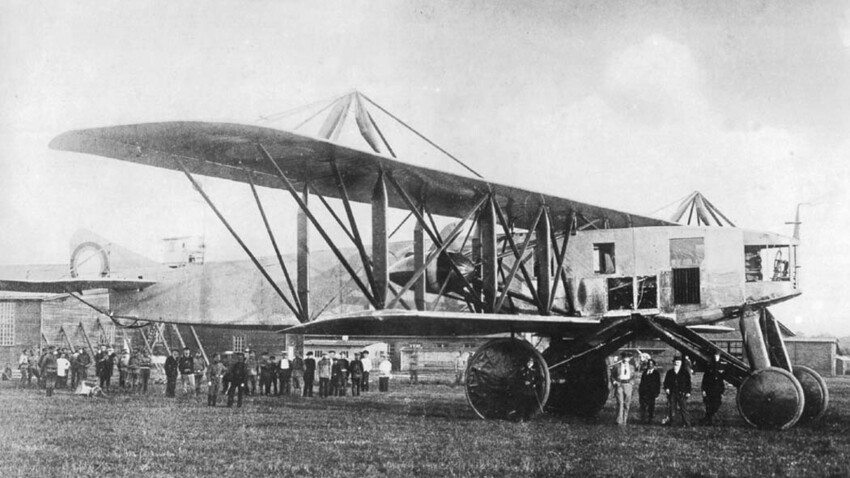

Do any of our Russian forum members have more information on this enigmatic aircraft? A basic description of the type can be found on Wikipedia and I can't seem to find out much more about it; I've only seen a few images of it published and I have never been able to locate a three-view. For such an enormous aircraft, very few images of it seem to survive.
Any further info/images are appreciated!
-Jared
Sturdy looking, I'll say that for it. Are those engine pods, I don't see anything looking like an engine or props.
I'm guessing two strut mounted pusher props driven by engines buried in the fuselage?
The above link has a picture that seems to show the props being belt driven from inside the fuselage.
Quote from the article at the site above: Airplane "Svyatogor" design which was launched in 1913, was a biplane of the classic scheme, but with the original placement inside the fuselage of power plant, equipped with a mechanical drive propellers. According to the original project design intended to use two German motor "Mercedes" of the total output of 600 hp The engines were placed in the center of gravity of the aircraft, the so-called "engine room", so that the on-board mechanics can pass freely between them in the service propulsion system during flight.

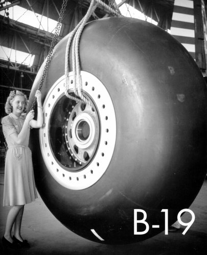

At the risk of leading smarter minds further off subject, but it is one of my favourite aircraft: the main wheels of the Douglas XB-19 were about 8'00 diameter.

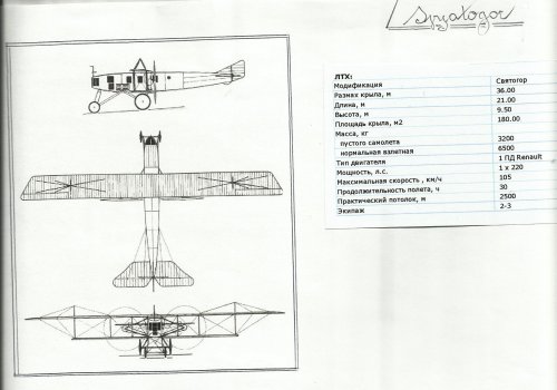

HI ALL
Svyatogor is a Russian mythical hero !
Well
but as I don't understand Russian, what is this
plane ?
I found this on the net but one of you could
translate ??
THANKS

Thank you very much Redstar72 .
I don't look in "secret project" !!!
THANKS AGAIN

All that i understood is
  • two Renaul engines of 220hp
  • speed of 105 km/h
  • crew of 3 person
up there are surely description of dimensions of aircraft,
Upper wing span (m) | | 36,0
Length in the flight line (m) | | 21,0
Wing area (m2) | | 180
Flying Weight (kg) | | 6500
Speed ​​at the ground (km / h) | | 114
Ceiling (m) | | 2500
Flight Duration | | 30 hours
(from http://flyingmachines.ru/Site2/Crafts/Craft28198.htm) translated with google translate
