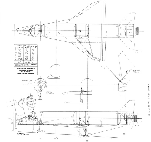

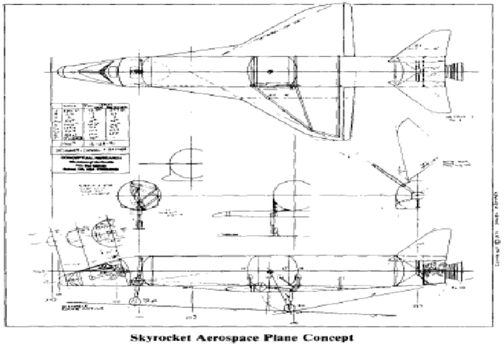

Skyrocket Aerospace

No, unrelated. It was an RL-10-powered vehicle to be carried by a large jet aircraft and then boost to orbit. I've never seen much on it. The diagram is, I'm sure, in at least one edition of Raymer Conceptual Design books, but it seems to be an edition I don't have.

"Cheap" space launch. Just heard back from Dan Raymer; it was a 1991 design for Hudson. All I have now is the diagram; it seems that the entirety of the payload was the two crew. Unsurprising given that it's a relatively small LOX/LH2 vehicle.
This was before the X Prize, before the space launch boom/bust bubble later in the 90's.
