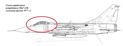

Im guessing, if the Soviet’s were serious enough, and deemed it a serious enough operational requirement (especially after the demonstrated shortcomings of the Yak-38’s performance), they could/would have at minimum kept Kiev as a proof-of-concept V/STOL heavy aviation cruiser; but incorporating structural changes into the design and building of Minsk (or at minimum Novorossiysk and Baku, had they been completed). These modifications could have incorporated the likes of a ski-jump, arrester gear/systems, larger and heavier capacity aircraft lift (or lifts) to facilitate the slightly larger dimensions of a heavier carrier-based MiG-23K and or MiG-27K variant(s).
Although saying this, I can only assume that the MiG-23K and or MiG-27K would be somewhat heavier, due to the necessity of structural and landing gear strengthening.
Im also thinking any MiG-23K/MiG-27K’s fuel and armament loads would have to be somewhat reduced to allow it to get off such a short deck, even with ski-jump assistance.
Im wondering if the naval variant would have necessitated pushing engine thrust to its limits.
One thing is for certain IMO, I wouldn’t be wanting to be barrelling down such a short runway, with everything depending on one engine!!
P.S. One thing particularly I liked with the 'proposed' MiG-23K, is the perceived vastly improved canopy/cockpit arrangement, which seems to have offered superior pilot visibility over the legacy MiG-23 'Flogger' series!! :p
Regards
Pioneer

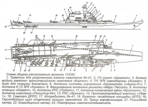

Thank you all for your input. To just briefly address more trivial matters, like i said initially of course the ships will have to be modified in the first place, but not a lot because as Vikramaditya shows, MiG-29K can operate off it very well, fits on the elevator, in the hangar etc. I see no issue with MiG-23A/K doing same, i am 98% certain the MiG-23A/K would have been just fine as a ski-jump fighter of a 280m modified Kiev-class, but to be absolutely sure of the feasability of this concept i am really looking for hard data (if there is any) from the tests made with MiG-27 no.603 operating from the ski-jump at NITKA to show one way or the other whether the tests were indeed successful or not.
The matter of landing is also a non-issue, the MiG-23K/A was designed to land on carriers, and as a sidenote during the painful history of soviet CV development in the first half of the 1970s there were proposals for the third and fourth Kiev class to be modified with catapults and operating MiG-23K and Su-25K, but of course nothing came of that.
Btw, here is the project 1143.42, which is how i imagine this MiG-23 capable Kiev to look like in the first place:
