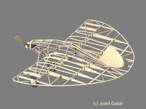

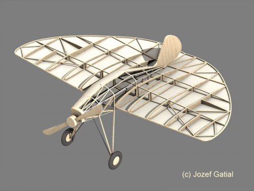

I'm no expert by any stretch, but i suspect materials we claim to be RF "transparent" are all but. I haven't seen any study comparing the reflectivity of, say, a one square meter flat woof panel at ninety degrees to an incoming radar signal, versus aluminum, steel, carbon fiber, glass fiber, etc.
All i know is that in applications where you care for radar transparency, getting 98% is very good.
Maybe this one...
