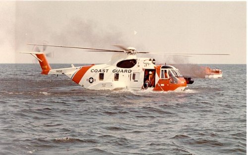

I found the statement here:
http://americanhelicopter.museum/aircraft/sikorsky-s-61-hh-3a-sea-king
But that might not be definitive. I just noticed that they say the S-61R fuselage was non-waterproof, which is definitely not true.
