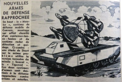

From the French Aviation Magazine, July 1960, a picture showing a proposed
version of the Shorts Tigercat:

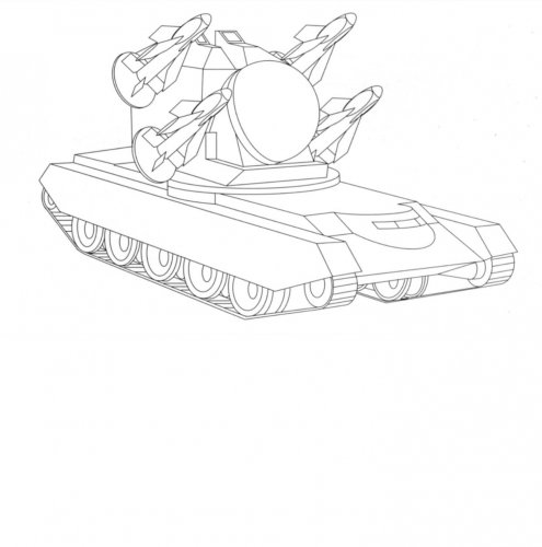

Here is another drawing of the Centurion-based Tigercat launcher. It seems the system might have an all-weather (at least 'dark fire' if not blind-fire) capability: note the radome of what could have been a tracking radar.
