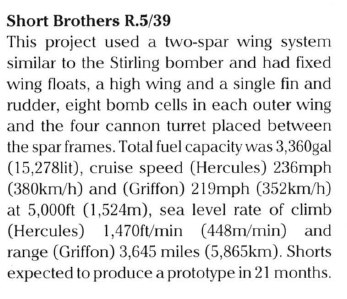

again the mystery Shorts proposal for R.5/39 flying boat,the data was available,
but I think no drawing ?.
That's the problem I keep finding with Short material in the RAeC archive; full tender documents but no drawings. Its very frustrating
