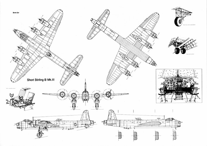

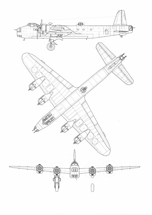

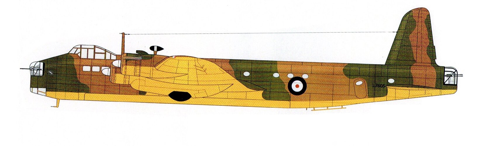

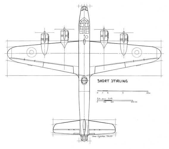

The Stirling is a rather poorly documented plane in France (less than the Halifax or the Lancaster which served under our cockades). On the other hand I like this big, low-performance thing but rather pleasant to drive apparently.us delivers my manual interpretation that I made of it. If some people can give me relevant corrections, I am happy to take them! Thank you in advance ...

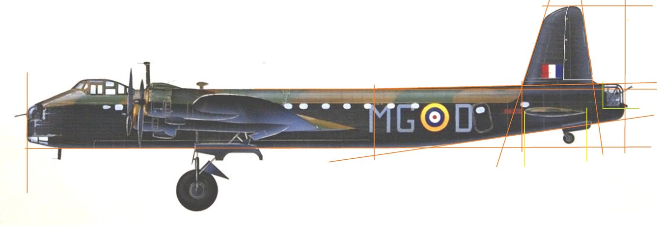

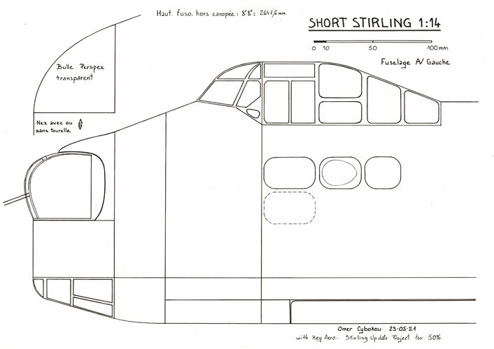

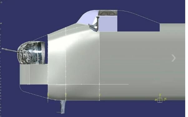

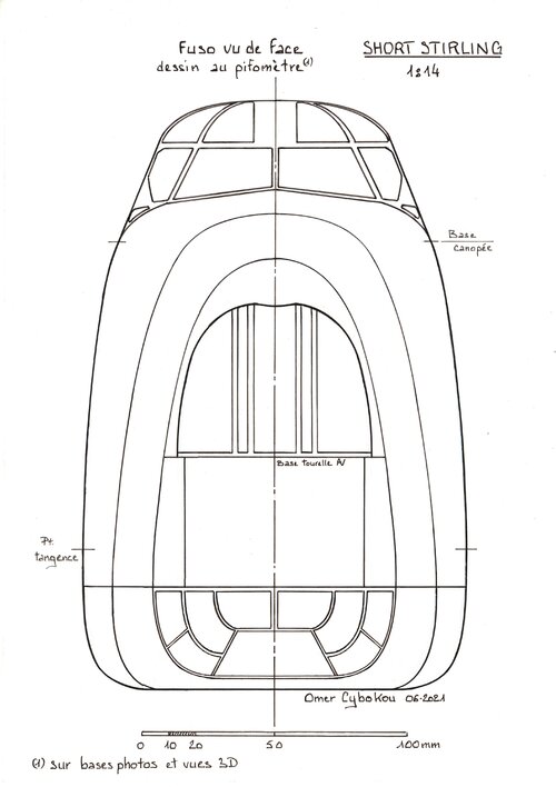

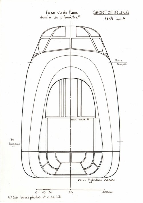

From 6 may I've modified my point of view of the forward fuselage and this is my conclusion. It's not exact but I have found something on Key Aero wich helped me to draw that figure : STIRLING DJ AVANT G2.jpg NEZ STIRLING 1.JPG
After many other things (as C-74 or B-29 ...) my obsession was to find a definition of the rear fuselage shape of this Stirling! Finally I set my sights on the superb track of Keith Fretwell whose pencil stroke is a legend for me. Because I need to know as accurately as possible the value of the angle at which the rump is raised in relation to the back of the fuselage. 98% of the drawings found are fake at this level (back straight on the whole length !!!), even the prettiest at first glance ! The track found in the group FB "Stirling Aircraft Project" is a valuable help to locate the point of inflection while Keith’s drawing allows to deduce the value of the angle. This will be my basis of definition.
View attachment 689153View attachment 689155

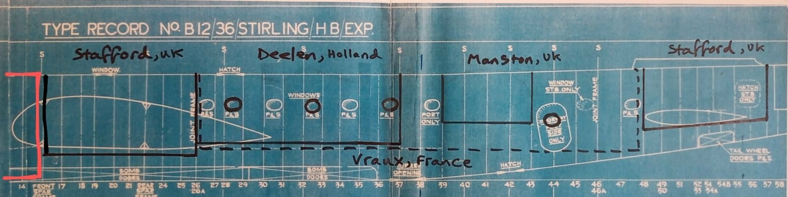

I just came across this video, which has a lot of technical information on the Stirling and features a contemporary weight & balance diagram, which probably is fairly accurate even if it's not intended as a manufacturing drawing:
View: https://youtu.be/IGPnEtkvBG4?t=427
(Timestamp 7:07 min)
