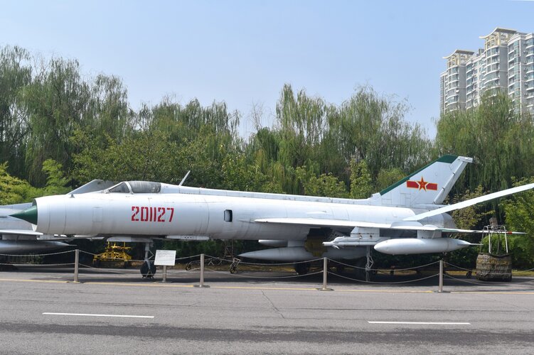

It would be interesting to read that as it would be a very difficult thing to verify. The programme that eventually became the J-8 was begun in 1964, but the so-called 'Cultural Revolution' had a significantly detrimental impact on the project (and the whole country!), which meant the project suffered lengthy developmental delays. The first prototype was completed in 1968 and although it superficially resembles the E152, there are significant differences between the two - the J-8 was intended on being twin engined from the outset and its fuselage is longer. In profile the early J-8 models with the intake in the nose does look simply like a stretched MiG-21 or J-7. The J-8 is physically larger than the E152 but lighter. This is a J-8I at the Shanghai Aerospace Enthusiast's Center.

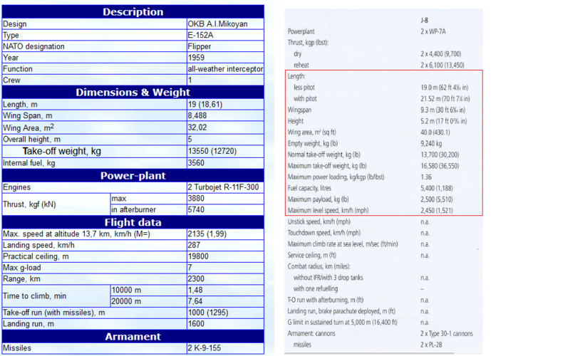

Instead, I put side by side Ye-152A and J-8I characteristics - once and for all, their weights and dimensions will be together, if people wants to whack their brains...
sources:
Ye-152A > https://www.testpilot.ru/russia/mikoyan/e/152/a/e152a_e.htm
J-8I > Chinese Aircraft China’s Aviation Industry Since 1951 - Yefim Gordon, Dmitriy Komissarov
