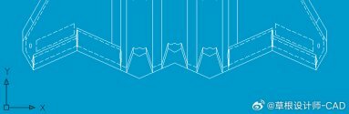

In this image, the view of the J-36 completely matches the photo, so I trust the image of the J-50 as well
With 23100 kgf / 14250 kgf engines, the J-50 gets a maximum speed of 1,900 km/h, a cruising speed of 1,500 km/h, a range without an additional tank of 3,000 km, with an additional tank of 4,000 km, a supersonic range of 1,600 km
A real picture is perhaps better for determining the length.

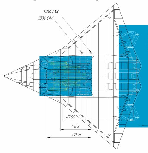

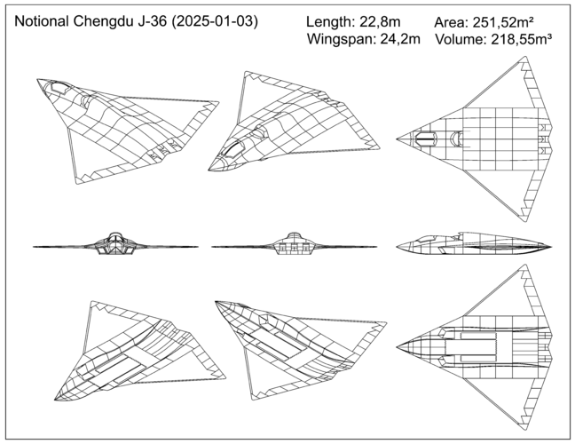

My attempt :)
This 3D model is based on the planform @paralay posted previously. It is a solid body with a volume of 218,55 m³ (!) Further, please note that all three air intakes have the same area of 0,656 m², which equals a circle of 0,914 m (36") diameter.

My attempt :)
Hats off! Well done my friend!!
