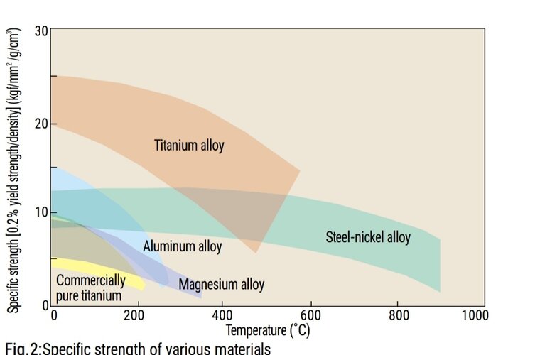

Titanium is used for the center wing-box, given it's high tensile strength, better ability to sustain load with a temperature rise, good behavior in fatigue a low deformation:
My understanding is: in the case of the B-1A titanium was not needed to go fast (as in the SR-71... with its SOVIET titanium, the ultimate Cold War irony)
It was needed to go low and fast - Mach 1.25 at ground level. On a VG wing aircraft.
Titanium is a great material for a swing wing pivot box irrespective of if the aircraft is supersonic or subsonic;- this component experiences very high concentrated loads/moments going into/out of the lugs. Aluminium would never make the fatigue life and steel would be too heavy.
Where titanium is needed on a supersonic supercriuse aircraft is in the highly loaded kinetic hot zones such as the wing leading edge. One of the issues with using titanium is that it’s difficult to integrate it with other metals due to thermal expansion matching, tribological compatibility and other structural issues. Hence if you need a titanium leading edge to hack the heat-n-loads, although the rest of the wing maybe within the range of aluminium, the simplest solution is to just make the whole wing from the stuff. In my experience, Titanium is painful to use as it has the ability to show an unheard of & unexpected problem in every new application.
