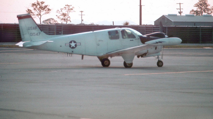

This thread is to examine the aircraft, systems, and networks that were involved in the 'electronic barrier' that was part of the McNamara Line, a defensive line developed to block North Vietnamese and Viet Cong soldiers from accessing South Vietnam along the Ho Chi Minh Trail. The aircraft known to be involved in the effort was the OP-2E, EC-121, manned and unmanned versions of PAVE EAGLE (Beech Debonair). Other aircraft supporting trail interdiction operations could also be included in this list.

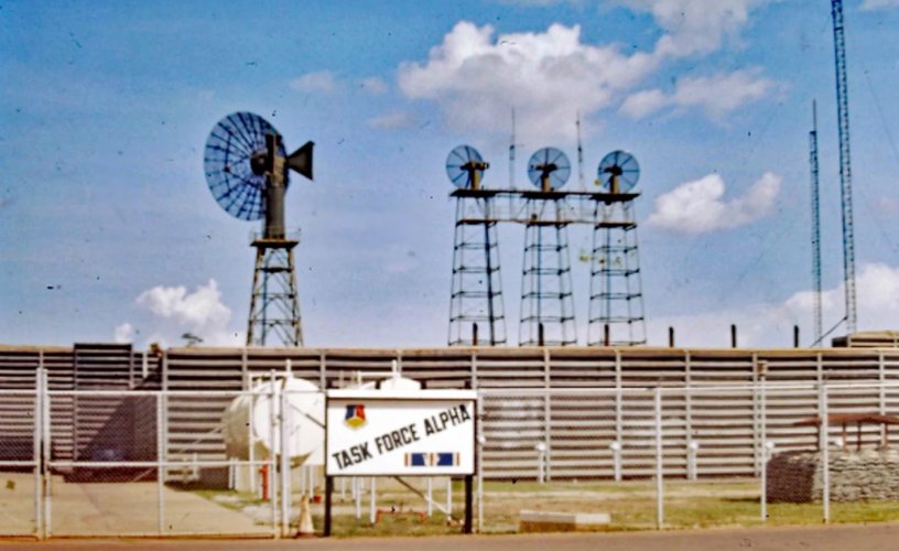

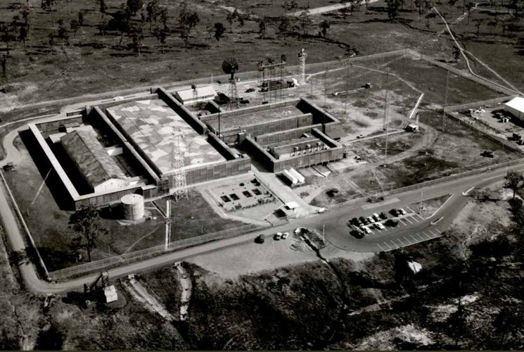

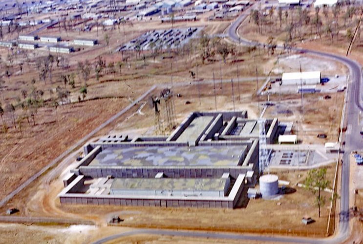

The Infiltration Surveillance Center (ISC) at Nakhon Phanom Air Base in Thailand. This was central node of operations for receiving data relayed from aircraft flying over the Ho Chi Minh Trail. Radiation (Harris Corp, today) was the contractor that oversaw the service of the installation. The facility was secret when it was built, only known as the Project, and was officially known as the ISC or Task Force Alpha.

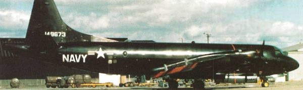

Black Orion P-3A
"In September of 1966, one of the Black Orions was detached from its operations over China and was assigned to a joint Department of Defense/Defense Intelligence Agency operation via the US Air Force. The aircraft was provided to support an intelligence-collection program in Vietnam codenamed “BENT AXLE.” The program involved gathering intelligence to locate Guerrilla encampments and NVA troop concentrations along the Ho Chi Minh Trail system of Laos and North Vietnam. The Black Orions operated out of Okinawa, Japan, at night and flew over Vietnam, conducting one of the first electronic intelligence gathering missions of the conflict. After 1968-69, the incorporation of electronic surveillance/reconnaissance in the Vietnam conflict commenced under an ever widening program called “IGLOO WHITE.”
"This aircraft was only used for a short time, flying directly from its mission over Vietnam to the United States and the Naval Air Station Alameda in January of 1967. The two other Black Orions followed several months later."

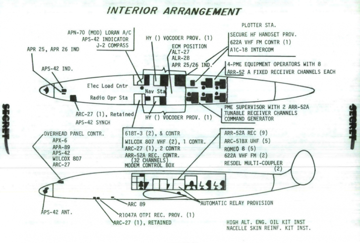

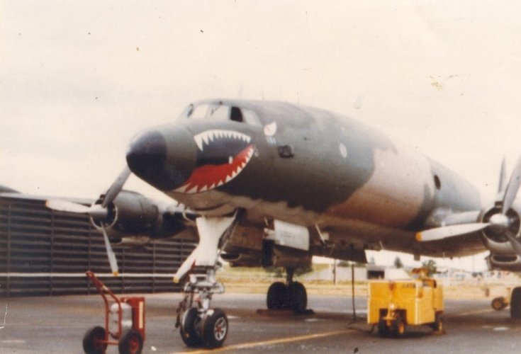

"Terrain masking (i.e., karst and mountainous features) prevented direct transmission from the sensors to the ISC. Thus, the need for an orbiting aircraft. The EC-121Rs also had a limited capability to analyze data in the event that (a) the ISC-based IBM main-frame computer was down, or (b) the ISC was unable to receive data from the orbiting aircraft (14-hour missions – one hour out, twelve hours on station, and one hour back)."
This brief article nicely summarizes technical issues related to Igloo White.
Uplink from earth sensors:
The sensors reported their data via radio frequency channels ranging upward from 162 megahertz (MHz) to 174 MHz on the very high frequency band. 31 channels were assigned to each type of sensor with a 375 kHz separation between each channel. Every channel contained 27 identification codes or addresses which could be set in the field prior to emplacement. Thus, a total of 837 individual sensors (27x31) could be deployed at any one time without signal duplication in a single operational zone.
Clearly, that meets the ARR-52 specs.
Downlink at NKP RTAFB:
The sensor transmitters would relay their data to the second element of the system, an orbiting EC-121R aircraft of the Air Force's 553rd Reconnaissance Wing, based at Korat Royal Thai Air Force Base. The EC-121s would then relay the collected information via a radio link at 2200 to 2300 MHz to Nakhon Phanom. At Task Force Alpha, the last of the three components in the system, the intelligence data (from a variety of sources, not just the sensors) would be entered, collated, retrieved, and stored by two IBM 360/40 (later two 360/65) computers. Technicians at the center controlled the system from a variety of video displays that were also linked to the computers.
