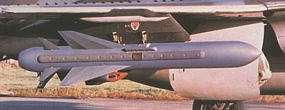

Sea Eagle was derived from the Martel ASM airframe. I believe that India took delivery of Sea Eagle to arm its Harriers and Sepecats.
Sea Eagle  - length 4.14m, diameter 40cm, weight of 600kg and a range of 110km. It is also powered by a Microturbo TRI-60-1 Turbojet. Production started in1982 and first went into service with the RAF buccaneers and Sea Harriers.
Kormoran (SA-34) which is 4.4m in lenght, 34cm diameter has a weight of 600kg and practicable range (early versions) of 37km production started in 1976.

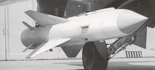

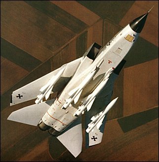

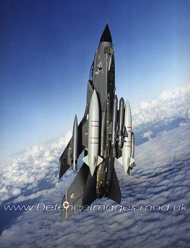

Sea Eagle pic from the Defence Image Database http://www.defenceimagedatabase.mod.uk/fotoweb/, not sure where the Kormoran pic is from, try the Impressive Weapons Loads thread on Key forums http://forum.keypublishing.co.uk/showthread.php?t=55087
