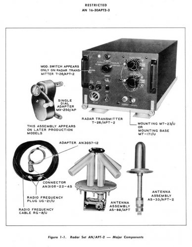

I don't know much about this but a cursory web search suggests SCR-596 was the APQ-9 "Carpet III" 475-585 MHz High Power Barrage Jamming Transmitter manufactured by General Motors (Delco Div.) series jammer designed to counter the Würzburg radar. There is lots of info on Carpet series of jammers, if that is correct.
What is the context in which you found this designation?
(Pic of APT-2 "Carpet" attached)
One of the two sources I found seems to suggest that the SCR-596-T2 was the preproduction version of the APQ-9, though the text is somewhat ambiguous.
The documents I'm using deal with experiments to jam tank communications on the battlefield. The SCR-596-T1 is specifically mentioned as one of the systems tested, with no reference to a T2 which may have come along later.
