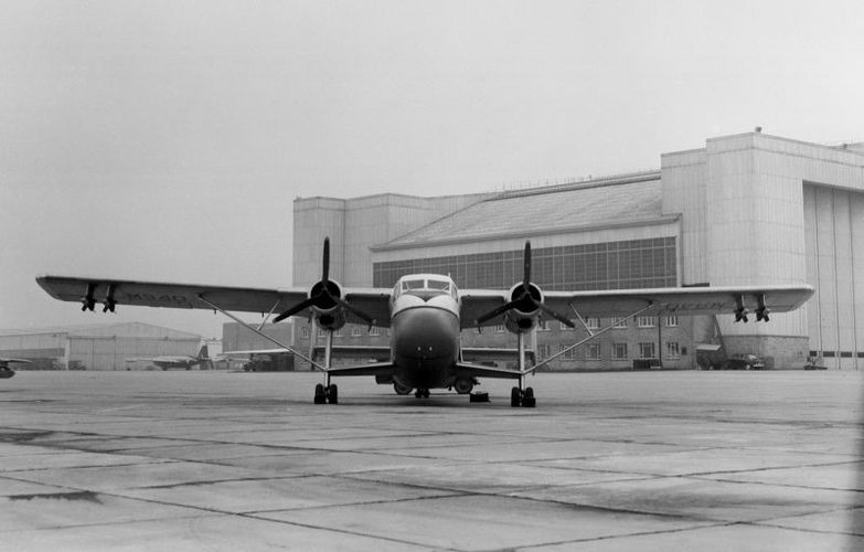

Here is an Image of a Twin Pioneer fitted with 4 SS.11 missiles i have found, so far I have been able to piece together that this was initially a modification carried out by Sud Aviation engineers on a Twin Pin in Khormaksar during the Radfan campaign, Initially these were configured as an experimental fitting. However during an incident when Hawker Hunters were unable to reach a group of rebels hiding in a valley, one of the local Twin Pins was dispatched with 4 SS.11 missiles under its wings, Its slower speed allowing it to drop right down into the Valley where it allegedly fired two missiles at the caves the Rebels were hiding in before returning to the base. After this my trail has gone cold however judging by the image I assume it was evaluated further in the UK, either at AAE&E, ETPS or somewhere else.
Air Britain's recent book Scottish Aviation Pioneers: Scotland's STOL Specialists by Chris Hobson doesn't add much to your posts above.
The bomb racks were never used in combat (they were fitted in Kenya to impress the locals and may have been used for flare dropping there), the SS.11s you mention being the only ordnance that ever left the Twin Pin in anger.

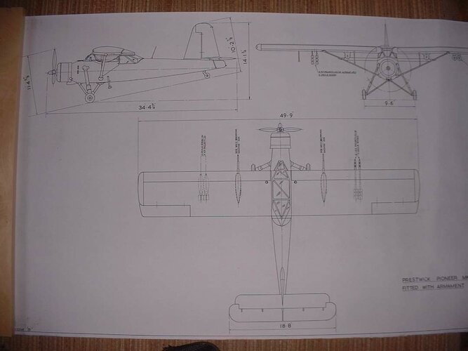

I didn't see anything in the book regarding armament on the Pioneer - though TsrJoe's image shows that Scottish Aviation must have thought about it.
