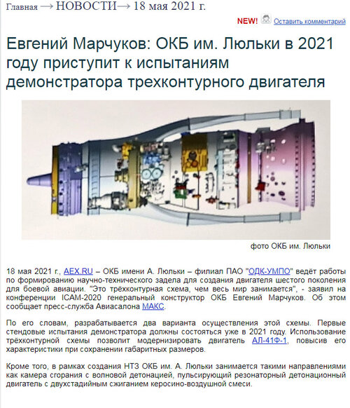

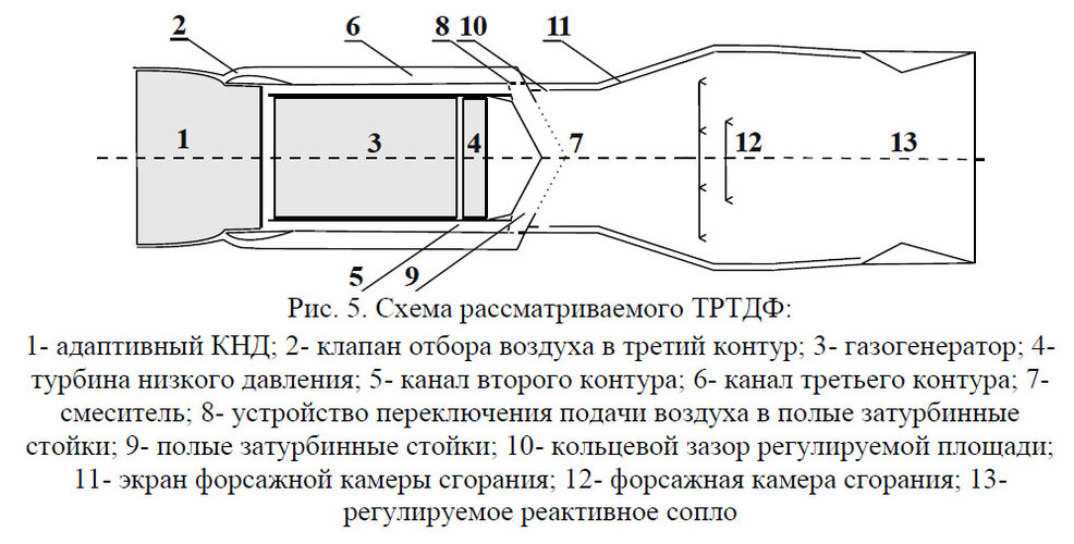

On May 18, 2021, AEX.RU - A. Lulka Design Bureau - a subsidiary of"ODK-UMPO"is working on the formation of a scientific and technical backbone to create a sixth-generation engine for combat aviation. "This is a three-contour scheme, which the whole world is doing," Evgeny Marchukov, general designer of the Design Bureau, said at the ICAM-2020 conference. This is reported by the press service of the MAKSAir Show.
According to him, two options for implementing this scheme are being developed. The first stand tests of the demonstrator are due to take place in 2021. Using a three-contour scheme will allow to modernize the al-41F-1engine, improving its characteristics while maintaining dimensions.
In addition, as part of the creation of the NTH OCB, I.A. Lulki is engaged in such areas as a combustion chamber with wave detonation, a pulsating resonative detonation engine with a two-stage burning of kerosene-air mixture.

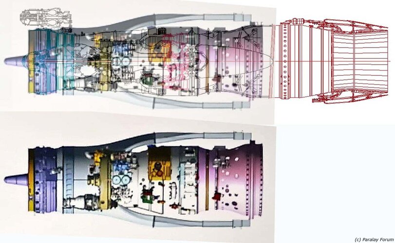

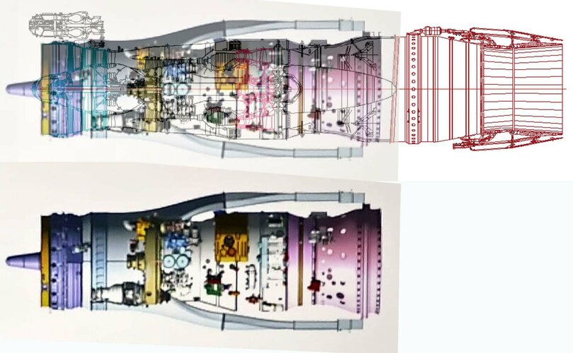

Fascinating. Is that izd 30? Looks like it has the same cold air bypass as it seems to show on the new tempest fighter. Perfect for cooling the exhaust, especially if aerosols are added!

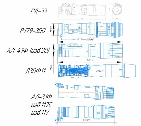

We would need an overlay with 117S engine to see any difference in size.
That would be very helpfull, thx.
I hope that it is izd 30, at least I hope that it is.
Well Salyut and Saturn have kind of their own thing in the development of AL-31F family.
and this makes me curious if they are still working with China.

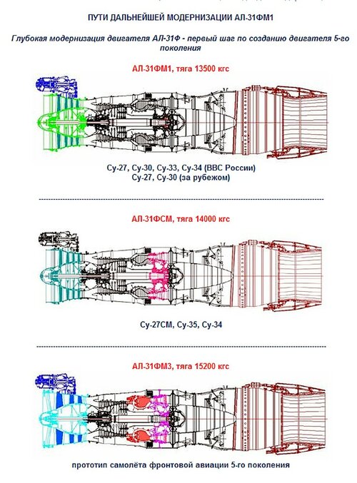

This is a development of the AL-31F from the Salyut company. I couldn't think of a better picture
Ok, copy that - the 2D background drawing is a Salyut AL-31FM variant. But what's the 3D overlaid CAD image, with the apparent 3rd stream ducts?
That long fan spinner reminds me of a certain unidentified Russian engine photo...

Based on the Izdeliye 30 engine, Saturn-Lyulka is working on a variable cycle (three circuits) military engine. According to Evgeny Marchukov, OKB Lyulka, two versions of this scheme are being developed. The first bench tests of the demonstrator should have started sometime in 2021.
