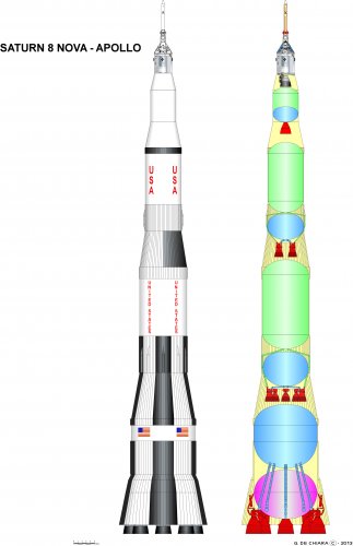

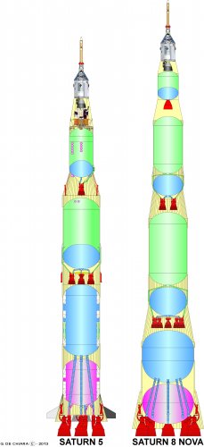

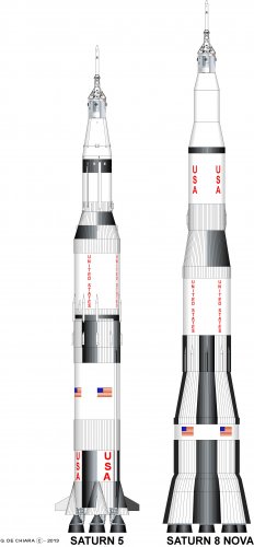

It was a MSFC proposal (as far I know) about a Saturn C-5 massive derivative within the framework of NOVA project, back in 1962-64.
[/size]
[/size]Enjoy it! ;)

I'm glad for your appreciation.

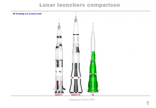

Anyhow I want to point out some striking resemblances with the Russian N1 rocket (even if C-8 is far greater).[/size]We know that Korolev elaborated the N1 shape called "raketov" by russians starting by Gottrupp early desings of mid-50's so it is difficult to argue a carbon-copy operation since at that time (1962) the N1 was design was already decided.In any case the two designs share lot of similiarities.

archipeppe said:
miraglia said:
Thank you for your excellent designs.
Miraglia
www.edgeofspace.org
Anyhow I want to point out some striking resemblances with the Russian N1 rocket (even if C-8 is far greater).We know that Korolev elaborated the N1 shape called "raketov" by russians starting by Gottrupp early desings of mid-50's so it is difficult to argue a carbon-copy operation since at that time (1962) the N1 was design was already decided.In any case the two designs share lot of similiarities.
That was quick. ::)

first Good work, archipeppe
on Saturn C-8
it's a strange case is this Saturn, is a Saturn or NOVA ?
definitely planed for manned direct lunar landing
here from the Unwanted blog
Great Peppe!
NOVA/Saturn-8 was for direct mission on the moon,but think that great dry workshop could be boost in orbit!

There are a few physics effects here.
1. With engines of a certain exhaust velocity, the rocket has a characteristic length where the base is full of engines. If you make the rocket taller, then you need to flare the base. Basically, when you reach full length, you can only scale sideways (constant mass per base area). You can't just scale up a Saturn 5 proportionally, or it couldn't lift off (or you'd have to have higher pressure engines). The base diameter must grow proportionally more than the other dimensions. And Saturn 5 was already flared at the base.
2. The N-1 used denser propellants, hence it was more cone-shaped (need more base area per length).
3. On the other hand, the N-1 used higher pressure engines than Saturn. So the base was actually not filled with rocket engines, if you look at photos. The rocket was cone shaped since the first stage tank had to be big, and the dense upper stages were thin. From the engine standpoint, the N1 actually could have been built with a longer first stage with cylindrical tanks and shorter and fatter upper stages. I don't know why they did not do that.
4. Also the Saturn 5 could have been built slightly more cone-like. but the upper stages needed to be quite fat because of the hydrogen.
Does it make sense to you?

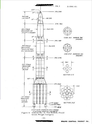

You can see the same 'flared base' characteristics in this four stage NOVA class launch vehicle from 1961 which combines liquid upper stages that appear to be identical to the ones on the Saturn VIII (C-8) with SRBs for the first two stages.
archipeppe said:
Miraglia
www.edgeofspace.org
Not as many as might outwardly appear...
The C-8 was not very well "fleshed out" in the design phase since it was basically never anything more than a proposal. Also, the construction of the two rockets were radically different.
The Soviets had a lot of problems building and transporting large rockets... especially in the 60's and early 70's. The Proton was the largest "realistic" rocket that could be built in pre-manufactured sections and transported by rail to the launch area, then assembled from the block components (external "strap on" tanks surrounding a central tank). N-1 was of course going to be MUCH larger, and Korolev wanted single oxidizer and fuel tanks per stage. The tank gores were manufactured in the industrial heartland of Eastern Russia and transported by rail to Kazakhstan, and then the rocket was actually manufactured from the component parts there. The large pressure vessels necessary for the monstrous tanks were at the limits of what Soviet industry could do, so they were manufactured in a simple spherical shape (most efficient and simplest pressure vessel to design and manufacture) but that made the rocket much taller than its American counterpart, which used cylindrical tanks with elliptical tank domes and a MUCH shorter intertank band between the fuel and oxidizer tank on the first stage. On N-1 basically the entire conical part of the stage was an intertank, going from the equator of the upper fuel spherical tank to the equator of the lower liquid oxygen tank. The aft thrust structure and manifold piping to feed the thirty NK-33 engines in a ring around the back was behind that. The upper stages of N-1 were also hypergolically fueled, which with its greater density reduced the stage size, but the poor ISP of storable hypergolic propellants meant MUCH lower performance and required larger tanks and more propellant to do the smaller amount of lifting it could do... it also required four stages instead of the Saturn V's three. The second stage was of the same spherical tank and large conical intertank construction as the first stage. These factors led to a MASSIVELY inefficient rocket design that produced around 11 million pounds at liftoff (versus Saturn V's 7.5 million pounds of thrust, and the C-8's roughly 12 million pounds of thrust) but could only lift about HALF the weight of a Saturn V... (about 70 tons to orbit versus the 130 tons of the Saturn V...) Plans were in the works for liquid hydrogen upper stages for N-1 that would have GREATLY increased its capabilities, but they weren't much past the proposal phase when they were canceled (other than LH2 engine work done by Isayev...)
IF we had actually seen the C-8 designed and produced, it would almost certainly have looked somewhat different from the proposals shown here... for instance, the first stage "ring" of engines is just about the worst way to do it... it creates a MASSIVE low pressure area behind the rocket that causes exhaust plume recirculation and massive heating of the bottom of the stage and the engines, requiring a substantial heat shield to prevent the structures from weakening or melting and to prevent the engines from being destroyed. N-1 originally planned to use "air ingestion" into the exhaust to increase thrust, and did to some extent, but the Russians underestimated the massive heat from exhaust plume recirculation in the base region and had to add a huge heat shield to protect the aft end of the rocket... which of course is extra weight. Part of N-1's problems were caused by severe base heating, as a matter of fact. One of the N-1's unused heat shields is actually a pavilion cover near the cosmodrome to this day-- it was inverted and put up on poles to make a massive covered pavilion!
The most logical way to reduce the base heating issue would be to put four F-1's in the center and another four in an outer ring offset by 45 degrees from the inner four, just like on the Saturn I/IB. The engines would have to be spaced wider than on the Saturn IB since the F-1's are much larger (to reduce power-robbing plume interactions between engines) but they would reduce the low pressure area in the center of the base area. These engines could probably be fixed, reducing the control complexity as well, just as in Saturn I/IB. The outer ring of four F-1's would of course be gimballed for control of the vehicle. The wider spacing between these outer engines would allow more airflow in between them, thus further reducing the base plume interactions. The large conical aft fairing wouldn't be required-- smaller half-conical fairings like Saturn V would suffice, probably equipped with fins.
The second stage tanks would likely have been a common bulkhead design, if at all possible... the massive weight savings over a double-bulkhead seperate tanks and the intertank required to connect them would create a huge payload advantage.
Later! OL JR :)
No, it was cone shaped due to using spheres for tanks
Over on the NASASpaceflight.com site there is further discussion of this vehicle. You can also find a link to a large file that addresses it and other Saturn options.

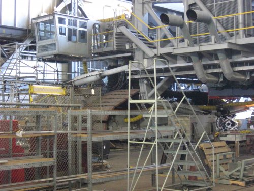

George Allegrezza said:
The crawlers are being upgraded with new diesel gensets and other updated equipment, giving enough capacity to deal with the SLS core and the 5-segment boosters. These upgrades were originally planned for Ares V, which would have been heavier than SLS, so they should be adequate.
Only one crawler is being upgraded. I think the upgrades have been completed. There's more detail on NASASpaceflight.com.
I got to see the work being performed on it last year when I took my group to KSC. Unfortunately, my pictures didn't come out very well. The VAB has lower lighting levels, they had the garage doors open behind the crawler, and they were welding with torches. So the lighting conditions were challenging! I'll see if I can post one of my pictures here.
One of the pics I took of the crawler as it was being upgraded. I didn't get to sit in the cab or anything. They were doing some structural modifications at the time.
There was an episode of dirty jobs where the host had to change grease in this thing. It really is massive.
"Holy cow! There's a hundred cops chasing down A1A after someone like they stole something What happened?"
"Some idiot let some visitor sit in the cab of Crawler #2, and left the keys in the ignition."
