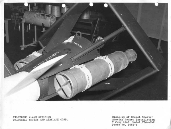

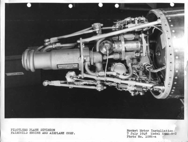

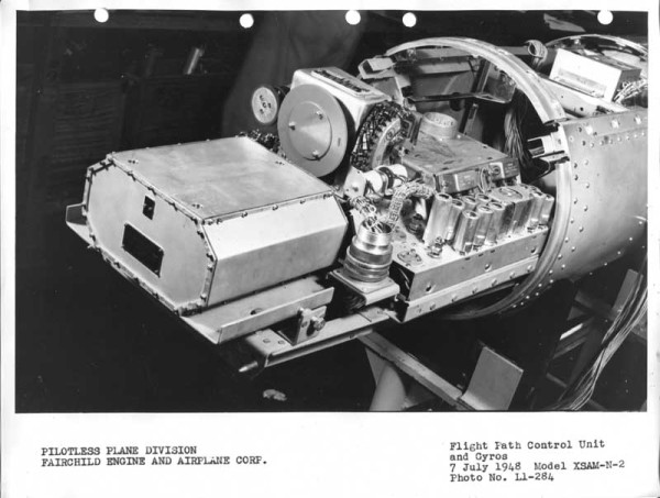

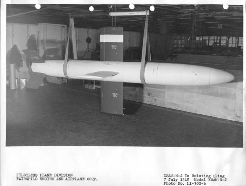

I can provide some visuals for the post.

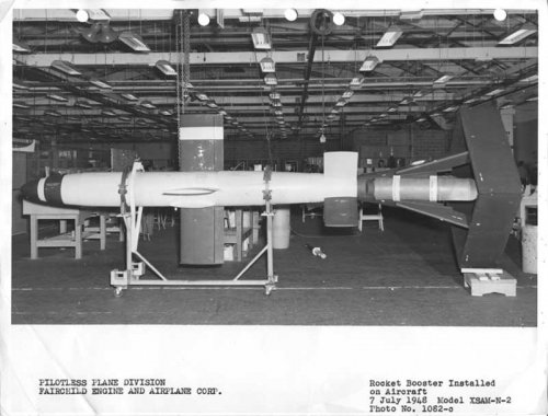

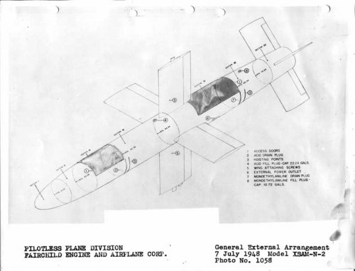

From NARA II 72AC-Box 130A
Fairchild XSAM-N-2 all photos July 7, 1948
  • 1082-b-XSAM-N-2-Close-up-of-Rocket-Booster-Showing-Rocket-Installation-19480707.jpg

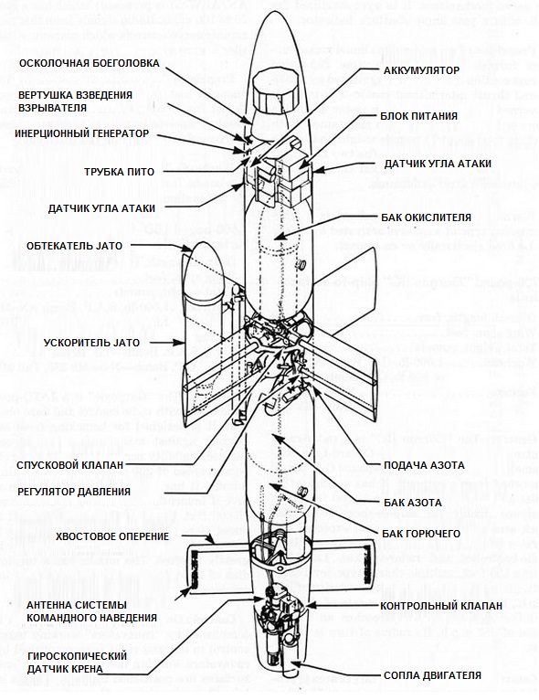

Both Lark missiles had a cylindrical fuselage with a rounded bow and stern. The length of the fully assembled rocket was 4.24 meters, with the launch booster - 5.64 meters. Its fuselage diameter was 18 inches.
The device of the original version of "Lark".
The missile was equipped with a cruciform wing in the center of the fuselage, which housed the pitch and yaw controls. The wingspan was 1.88 meters. In the tail of the rocket there were X-shaped rotary stabilizers, which served to stabilize the flight of the rocket and control it in a roll.
The rocket was propelled by a LR2-RM-2 twin-chamber rocket engine designed and manufactured by Reaction Motors. It was one of the first mass-produced liquid propellant rocket engines in the United States. He worked on aniline (fuel) and red fuming nitric acid (oxidizer). The supply of fuel components from the tanks was displacement, using a cylinder of compressed nitrogen. Component supply pipes ran around the combustion chamber, performing regenerative cooling.
Lark engine.
Two combustion chambers equipped with nozzles of different diameters produced, respectively, 90 kgf and 180 kgf of thrust. The first was considered marching and worked continuously, the second was activated only when the flight speed dropped below the set one. Thus, in flight, the Lark maintained a more or less constant speed of about 1046 km/h (650 mph).
The rocket's tanks held 222.3 kg (490 lb) of fuel and oxidizer. The oxidizer tank was at the front of the rocket, in a carefully insulated section - fuming nitric acid is extremely corrosive. The fuel tank and the nitrogen cylinder formed a single structure, separated by a common partition. The flight time of the rocket was about 5 minutes.

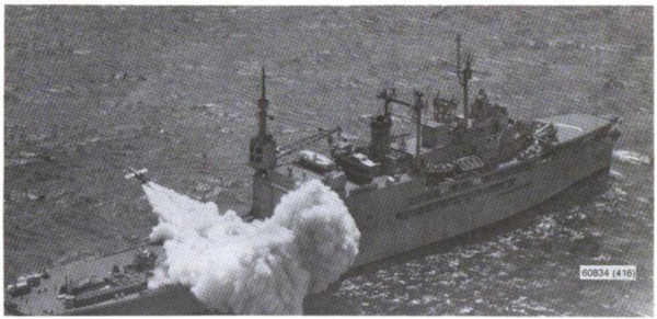

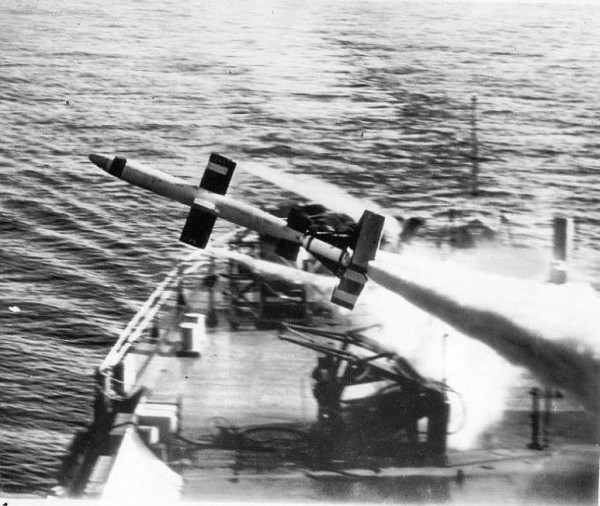

The first ever launch of an anti-aircraft missile from a ship.
On January 10, the first successful launch of Lark (model KAQ-1) from a spacecraft was performed. Thus began the long and successful career of Norton Sound, which served as a test platform for virtually all new naval weapons systems from 1948 to 1986.

Lark launch from Norton Sound.

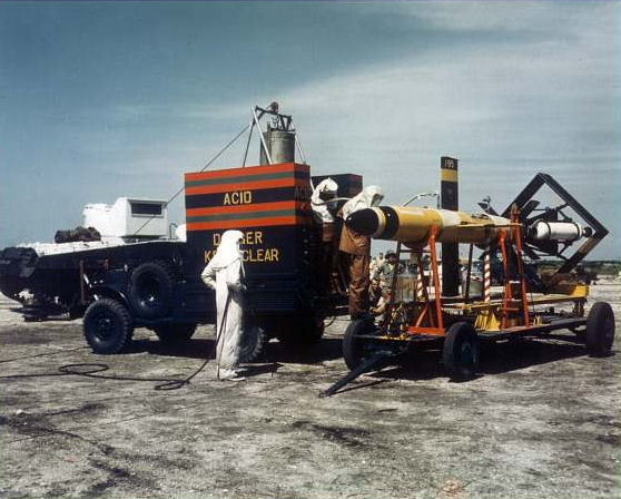

Refueling "Lark" with an oxidizer. The chemical protection suits of the technicians make it clear that this procedure was extremely unsafe.

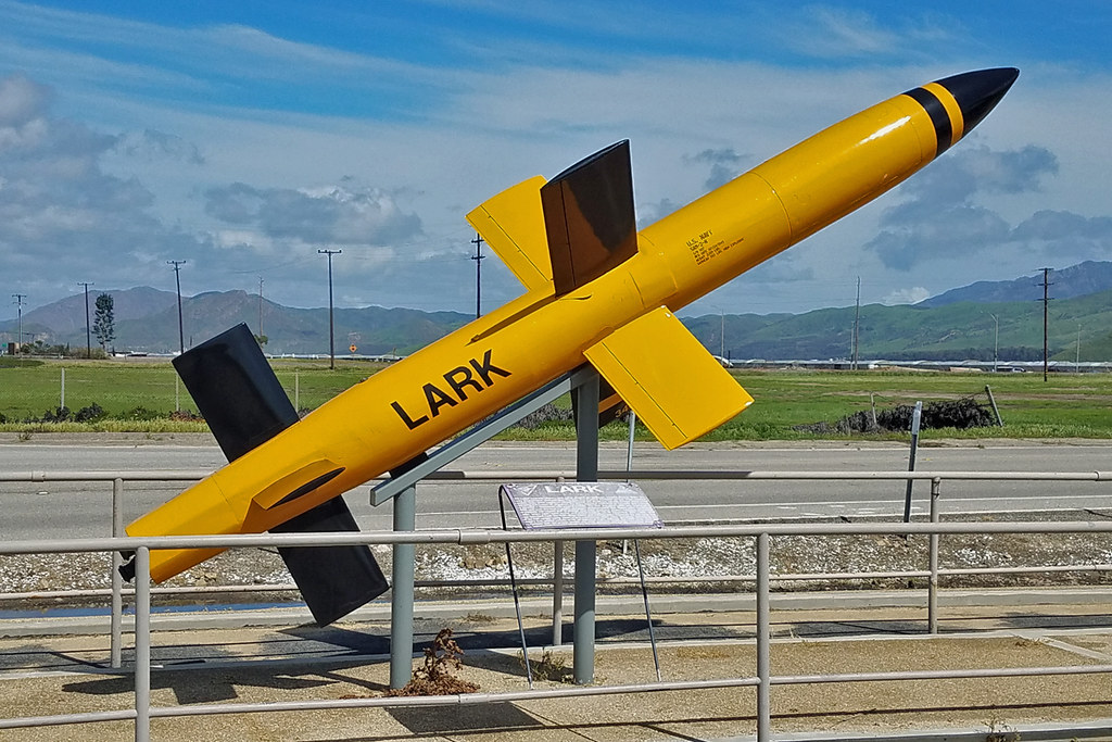

"Lark" at the US Navy Museum.

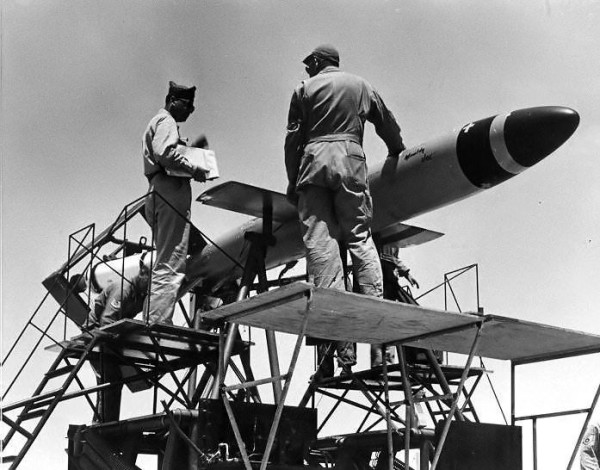

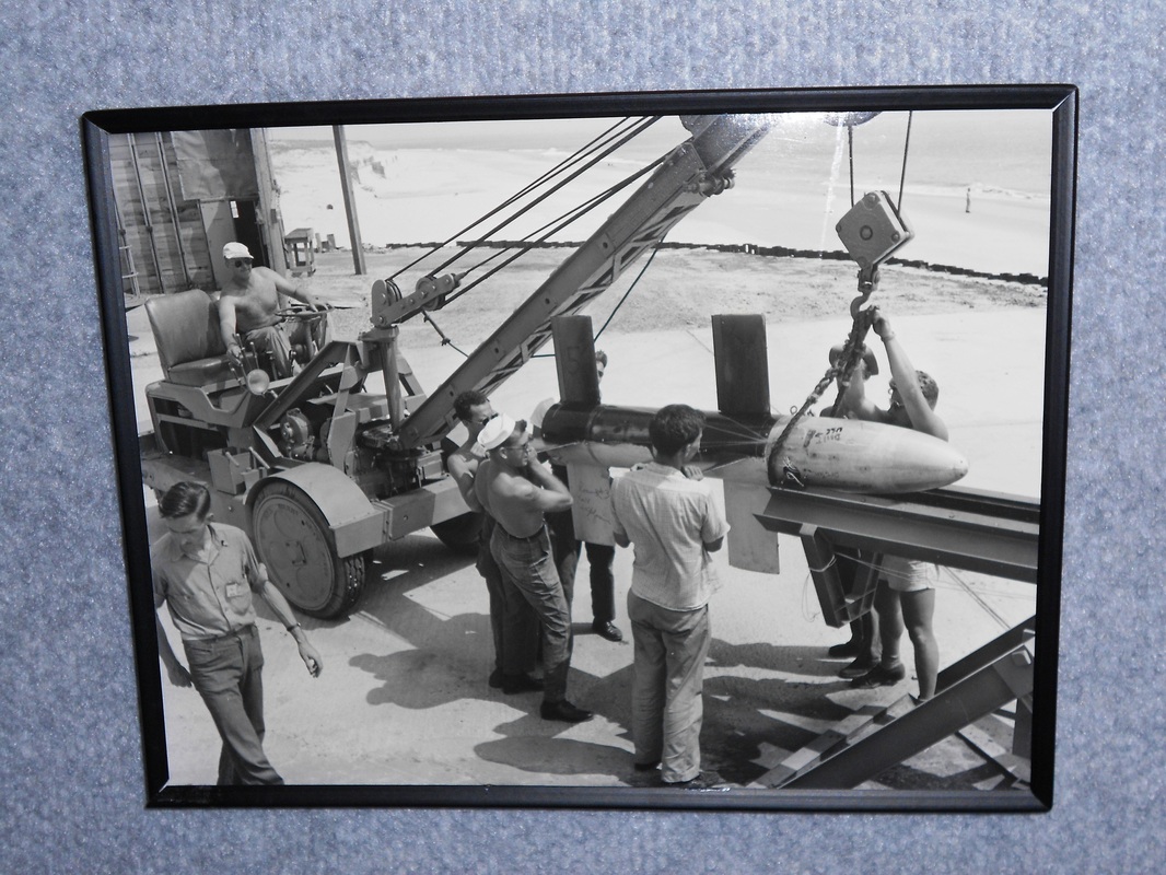

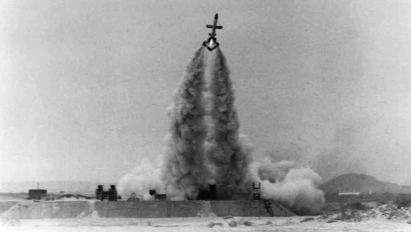

The top photo is actually the CTV-N-9 (and later -10) version of the Lark. These were ordered by the USAF for missile flight control testing in 1949. The middle photo is of a Lark launch at Inyokern CA (aka China Lake). The bottom is USAF personnel fueling a CTV-N-9 prior to launch.
The USAF ordered 50 in 1949. These were shipped to Cape Canaveral FL for testing. The test flights were made from Launch Complex 1 and 2 throughout the early 50's.

The US Army then picked up Lark as the RTV-A-22 and used it to develop their Lacrosse tactical missile.
Thank you for clarification!

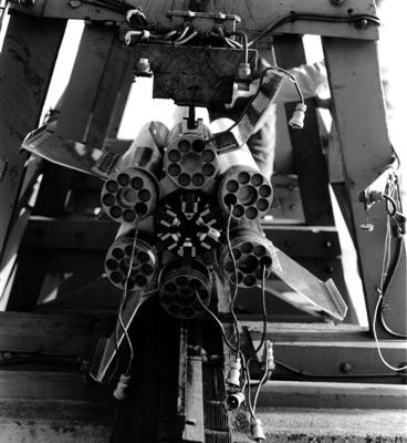

Also derived from Lark was the CTV (Control Test Vehicle) series of subsonic missiles used to develop flight controls for the Talos missile as part of Bumblebee.
R.5f8ecc217aa32a18e36b61cddb1ecc76
A CTV with boosters on the launcher at Topsail Is. N. Carolina,
R.c29980e585519e479b0c5a466c81b6b5
Close up of the rear of a CTV ready for launch
