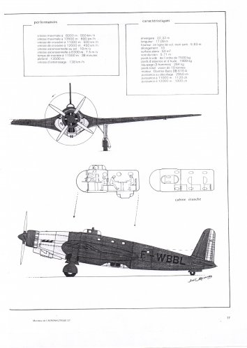

Thanks Jens !
but it seemed that it is more difficult !
Since I've asked here I've continued to
try to have an answer...
and I found something on an old
"air enthusiast".............look
Thanks again, Bye PAUL

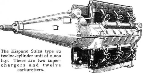

Perhaps the source refers to the HS.24Z Type 82 of 1946, a water-cooled, vertical H-24, 72-liters displacement--essentially four of the V-12 blocks on a common crankcase.

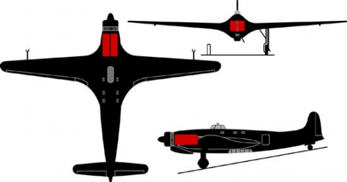

My dear Just Miranda
Thank you for your beautiful 3 views
especially the cockpit is very interesting for me
Your view show the plane at its initial flight
THANKS AGAIN paul
My dear Iverson
I don't think so, the choice of the engine
is dated of 1942 for two side by side engines
HS 12 z of 1300 cv in the fuselage and partly
in the wing roots ???
It's that which I don't understand and I will
be happy to see !!
Thanks my dear
PAUL
The NC.3021 had very thick wing roots, that perhaps were just a remnant of that
first engine installation ? When the pressurized cabin was left more or less unchanged,
it would have devided both engines and the description in the AE article seems to be
quite plausible.
Bonsoir Jens
So, it is possible that the two planes was edentical ?
exempt for the two contrarotative airscrews which
could give the nose of the plane longer ???!!!
Have a good week
PAUL
In the AE article it is said " work on the SO 3020 stopped ..... and work on the SO 3020 was resumed as
NC 3021". To me that indicates, that both were actually the same airframe.

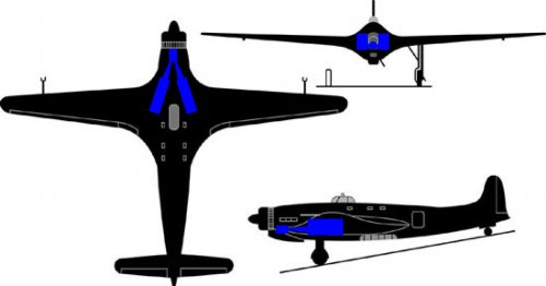

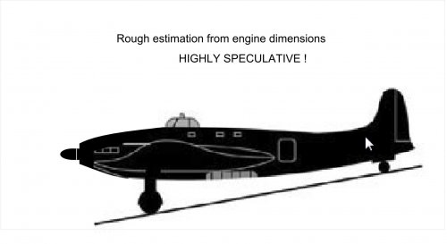

Have tried to write in two HS engines into the wing roots, adding a shaft and a gear for the contraprops.
I would assume, that the cooling intake would have been positioned in the wing roots, too. The circular
radiator in front of the engine was a typical feature of the DB 610, but there would have no reason for
such an installation in the case of two HS 12 engines, I think. So, the nose actually could have been shorter !
But again: Guesswork only ! ;)
Hi Jens
THANK YOU
Very well, I see, That's certainly right

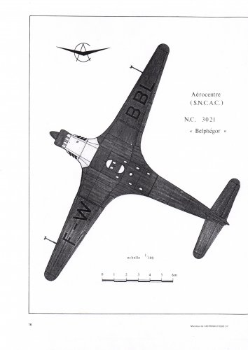

In the AE article it is said " work on the SO 3020 stopped ..... and work on the SO 3020 was resumed as NC 3021".
This mean that a project started at SNCA-SO was transfered to SNCA-C... pretty weird, but then again - it was Vichy, and it was utter misery...
