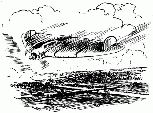

in this book,a group of artist drawings to a real aircraft,one of them is
a mystery tailless aircraft,was it a real design or not ?,I put it here
because may be it was from the author imagination ?.
http://scilib.narod.ru/Avia/Vishenkoff/index47.html
In the text (the link Hesham) refers to the flight test aircraft Cheranovskii BICh-14.
http://www.airwar.ru/enc/law1/bich14.html
Although the name of the designer and the aircraft type is not specified, but based on the above surnames test-pilots and quite detailed description of the aircraft that it should be in the book talking about the BICh-14.
But on the figure shows a different single-engined machine, although structurally similar.
Who ID this plane?
