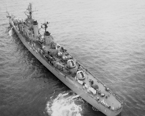

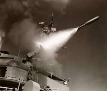

...and this is a photo of the launcher doing it's thing;
Unlike the ASROC, which carries a nuclear warhead or a Mk.46 Torpedo, the Weapon Able drops a conventional depth charge into the water (you'd better be a damned good shot to nail a sub!), and has only a single launch tube. That said, it's pretty obvious why it never caught-on.

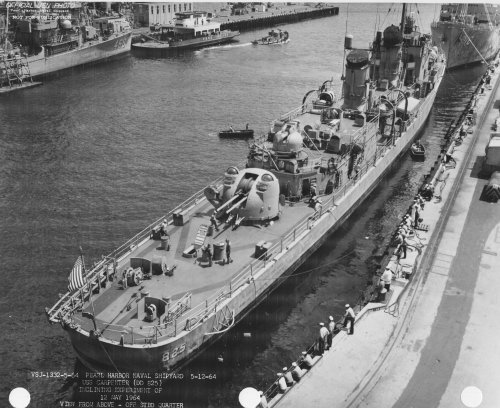

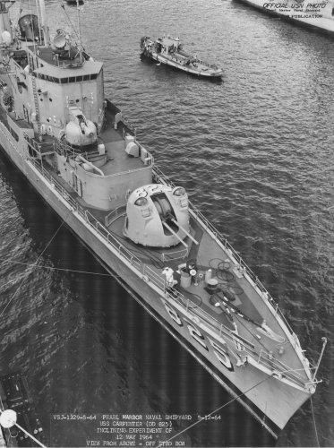

My father was an officer on the USS Carpenter (DD-825), which was one of only a handful of warships ever fitted with the Weapon Alpha. She was also one of the first to carry the Weapon Alpha, so she was a sort of a testbed if you will. Now, this being the US Navy, that also meant that she was a showcase for selling Congress on giving the Navy more funding, by showing-off her shiny new toys.
In one such occasion, my father tells me, the Carpenter played host to a large delegation of VIPs, who were treated to a demonstration of the weapons on-board (others of which were *also* very uncommon stuff, like the Mk.37 twin 3"/70 gun). As the crew trained the launcher all over the place, CDR Melvin Earl Bustard (the ship's CO) gave a detailed summary of the weapon's role, specifications, history, capabilities, and so on, and eventually the Weapon Alpha came to a complete stop. Bustard told the delegation that this "dry run" indicated that weapon had locked-onto the target, fired, and the target had been destroyed.
In reality, the Weapon Alpha turret stopped suddenly because it broke down! XD
Here's a photo of the Carpenter, in which the RUR-4 Weapon Alpha and Mk.37 3" gun turret are both visible;

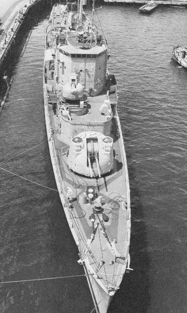

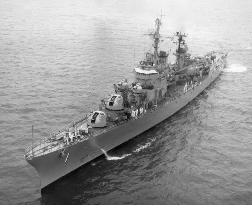

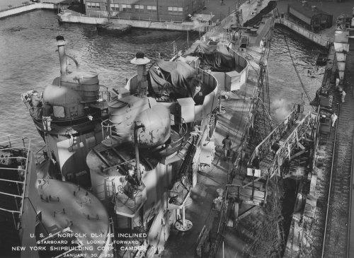

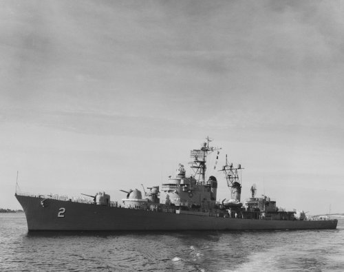

Here's some photos of Weapon A installed on DL-1

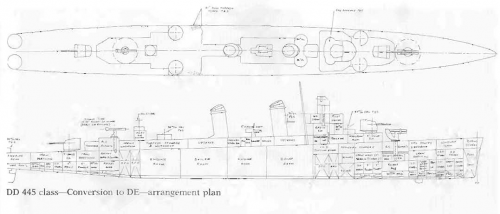

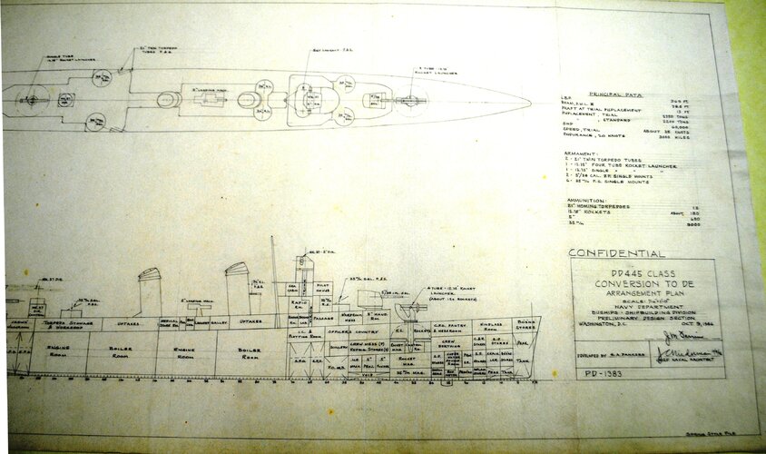

It may be of interest that according to Norman Friedman ('US Destroyers - An Illustrated Design History', p. 256) originally the US Navy planned a four-barrel model of Weapon A (with 200 round per launcher). Later they opted for one-barrel version (and the magazine capacity was halfed).
Here is a drawing of a ASW conversion of a Fletcher-class destroyer in which what apparently is such a 4-barrel weapon may be seen. The drawing comes from the book (p. 265).
Piotr
Piotr
And here you've got a drawing of the Fletcher conversion in high resolution in which the four-tube anti-submarine rocket launcher is clearly visible. The drawing comes from the 'Spring Styles Volume 4' that is being linked (so may be downloaded) in another thread: https://www.secretprojects.co.uk/threads/us-navy-spring-styles-ship-designs-book-4-1946-1954.39443/
