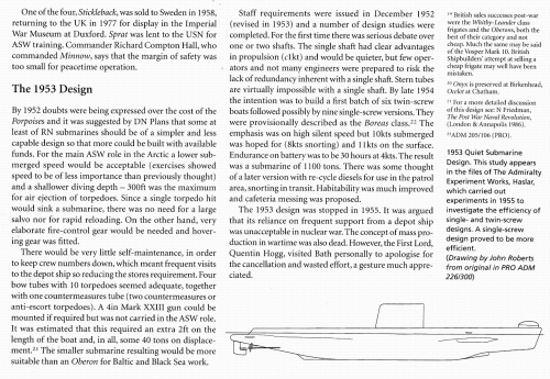

Here is the extract for the 1953 Quiet Submarine design, from Brown and Moore 'Rebuilding the Royal Navy' (2012 pbk edn), p.117.
There is no mention of nuclear propulsion, being more a series of diesel submarines with some use of re-cycling systems, probably based on German research. The references to nuclear submarines in Brown and Moore offer no insight into small designs, the earliest nuclear designs of 1950-1951 were around 2,500-4,500 tons.

Thanks Hood. Interesting, and appropriate, choice of class name for the twin screw version:
http://en.wikipedia.org/wiki/Anemoi#Boreas
http://en.wikipedia.org/wiki/HMS_Boreas
