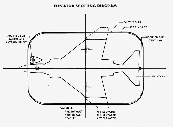

In reality this requirement does not appear to have made it to industry, but it is fun to imagine that it did and wonder what industry might have come up with. Trying to keep close to the stated requirement does create some significant constraints though. This would be a rocket fighter, so it would have to be configured in such a way that the rocket installation was practical, it was also to be single seat and would have to fit on RN carrier lifts (see the diagram attached of a Phantom on RN lifts for reference) and would have to have various devices to improve take-off and landing performance, e.g. blown flaps and jet deflection as actually included in the P.177 design. Whilst the requirement was more demanding, had it gone forward the RN would have had to have accepted an in-service date of 1965 (planned in-service date for the P.177RN was 1960). Having thought about this, two potential approaches come to mind:
