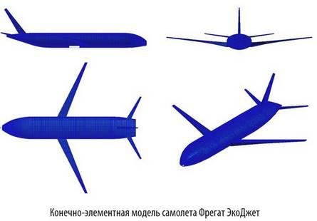

The idea is apparently still alive, though it seams to have lost its twin vertical stabilisers. No idea what they expect to gain from from the flattened crosssection except more wetted area and a bunch of structural problems - I thought the A380 tall elliptical section was pretty crazy.
While the proposed design would fit the niche occupied by the high-capacity Ilyushin Il-86, the organisation behind it, Rosaviakonsortsium, says the EkoJet's take-off weight would be some 80t lighter.
These renderings give no indication of the proposed engine location but I do like the incredibly high aspect ratio wings and fins. Perhaps they're trying to get to U2 altitudes to save fuel.

Don't read much into the wing design as depicted, it's a finite element analysis model which incorporates only the primary structural members. What you see is probably just the wing box without LE/TE devices.
Agreed but it would have been cool though.

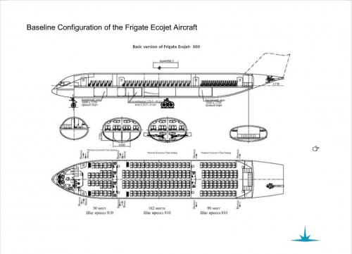

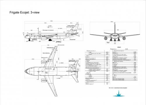

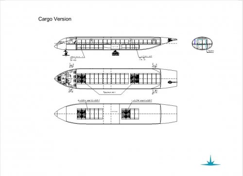

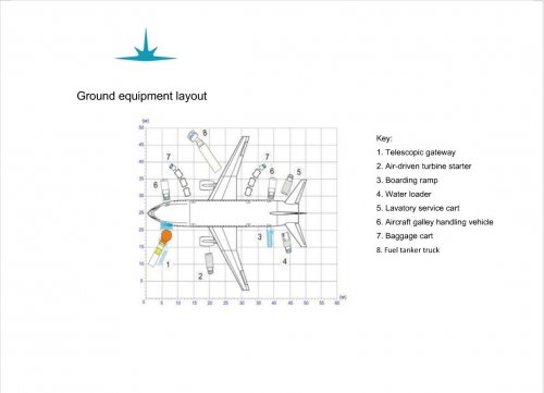

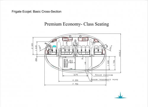

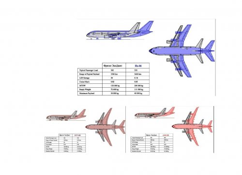

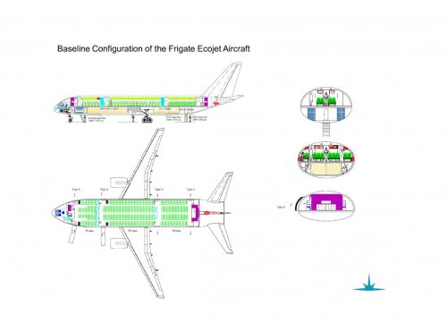

More Details have emerged on this project "Frigate Ecojet"
Frigate Ecojet, Next-Generation Wide Body Short and Medium haul Aircraft
Download http://www.4shared.com/document/yPLbc7SQ/frigateecojet.html
Screenshots from Russian Avia Consortium Corporation Frigate EcoJet presentation.
http://www.slideshare.net/travnikov21/frigate-ecojet-5170863

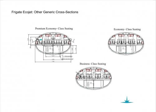

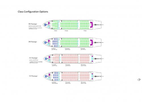

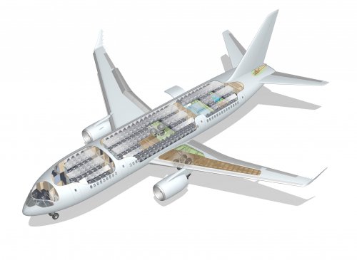

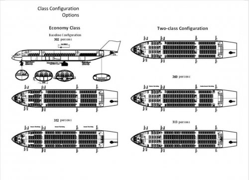

Ecojet promises economy with three aisles

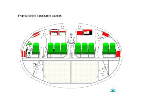

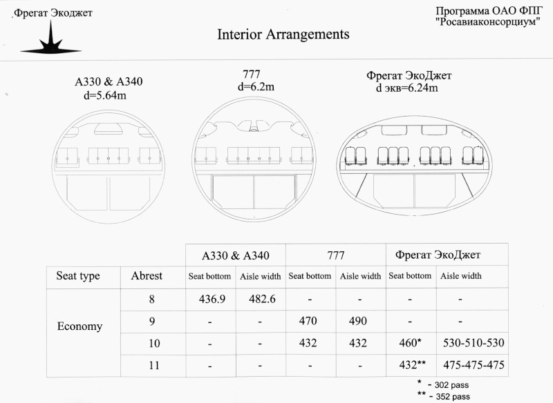

Dubbed “Eco-jet”, this twin-engined transport would seat between 280 and 350 passengers in a wide, ovoid fuselage – reminiscent in shape to designs proposed for the Airbus A3XX over a decade ago.
With a fuselage cross-section which is considerably wider than the Airbus A330/A340 or Boeing 777, the Eco-jet would accommodate three-aisle cabin layouts with seats 10-abreast, or 11-abreast in a high density arrangement.
According to data shown to delegates at the Wings of Russia International Aviation Forum in Moscow this week, the Eco-jet would be able to fly a payload of 200 passengers 3,350 nm., or 352 passengers around 1,100nm.

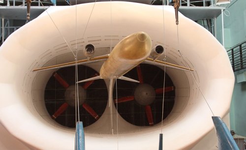

Wind tunnel model of Rosaviakonsortium Frigate EcoJet
http://www.frigate-ecojet.ru/en/press-center/news/2012/frigate-ecojet%E2%80%9D-was-tested-in-takeoff-and-landing-modes.html
