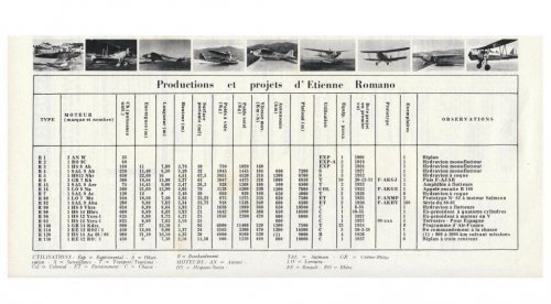

Dear Stéphane, is this all you will need to make a Romano designations list for Etienne Romano's aircraft?
The list comes from the 15th March 1967 issue of Aviation Magazine International......
Terry (Caravellarella)
  • Romano designation list - Aviation Magazine International - N. 463 - 15 Mars 1967 1.......jpg
How could I hope for more?! :eek: I only had half of these... ::)

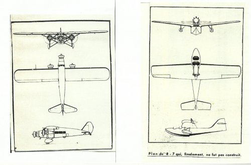

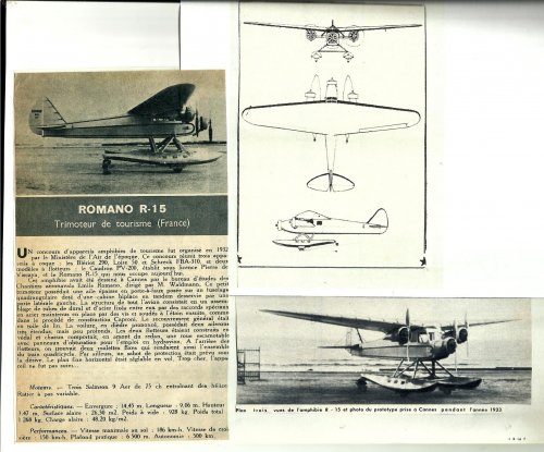

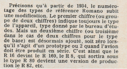

To know Romano series,
the single number mean the Model designation Project,or it actually built until R4,and from R5 & R50,the addition Zero,was meant a prototype,and for production; the addition number changed into 2 or 3 if there was improvements or new concept,such as R8,became R80 as a prototype,R82 for production,and R83 for more modification,if the addition number was "1",that means a further developments,and if the addition number before the original one,means more improvements,such as R6 & R16.
From Aviation Magazine.

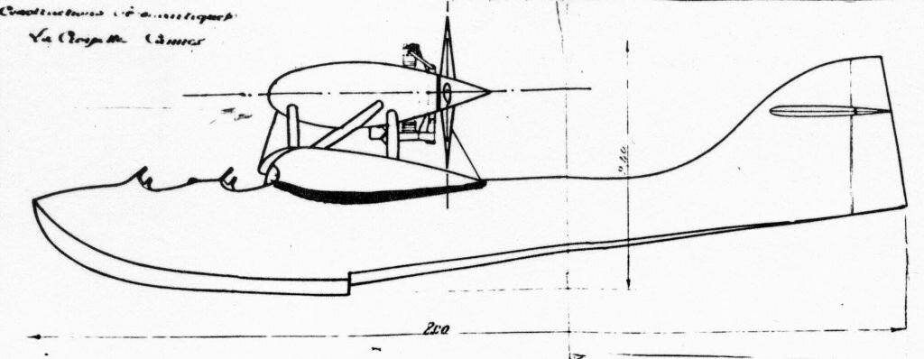

  • R.7 (?) Flying boat, one Salmson 9 Ac 120 hp. Project only, mentioned by Liron, unconfirmed since.
This is simply an hypothesis from Jean Liron, but unfortunately, he had no clue. The original plan does not show any designation.

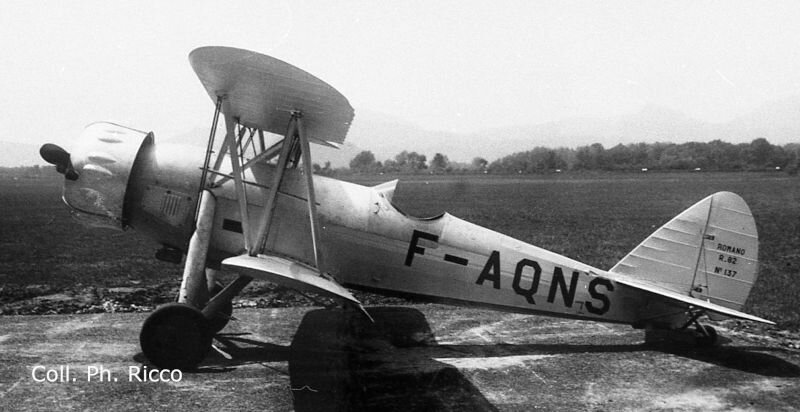

  • R.83 Variant of the R.82 license-built for Spain by the Belgian company LACEBA. 24 ordered, at least ten built.
I do not agree with that. It was an error from Jean Liron in Aviation Magazine. The Romano 83 was the designation used for the single-seater version of the Romano 82 with smaller wingspan, delivered in Spain.
I published the detailed story of these planes in Avions N° 212 July/August 2016.
  • Romano 82 no 137 F-AQNS monoplace, ailes courtes - Cannes mai 1938 (Traverso).jpg
I forgot to precise that the first who clarified this Romano 83 identification was the Spanish historian David Gesali, in his Catalan-language book:
