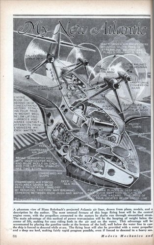

here is a drawing a four-engined huge flying boat aircraft,designed by Hans
Rohrbach,all details are in Modern Mechanix magazine,I suspect in that
paint my done by the author,so I put it in this section,until we can see,if
it was a real design or a hypothetical one.
http://blog.modernmechanix.com/my-new-atlantic-air-liner/

An interesting find indeed, as the designer himself, Hans Rohrbach, tells us about this concept !
Maybe it would be helpful to have the other pages of the article, too. Principally I would second
Stargazer, but even great designers have their dreams. He says, that he actually had designed
this flying boat, but from the text it may well be, that he just collected changes he thought to be
needed, like internal engines and probably a different hull shape to improve seakeeping.
