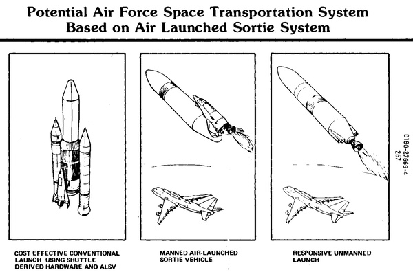

I seem to remember a huge vehicle that looked like a giant Energiya/Buran deal--- a lot like the B2 ASLV but exaggerated even more in favor of the booster---below (far left)
ASLV
From Dwayne's page here:
