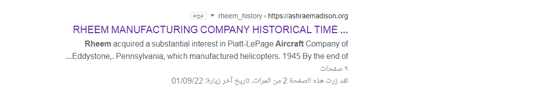

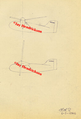

the Rheem Manufacturing Co. acquired Platt LePage in 1944,it designed some target drones,such as R-164 and R-180,also it created a VTO aircraft project in 1947,as I have in my files,it involved in a VTOL design,who know more ?.
This site (in picture # 2) is not open !.

The VTO project was Haviland Platt's Tilt-Rotor.
They would have been involved with a number of Platt-LePage projects, if economic conditions in 1946 had turned out better.
A family friend who worked at Platt-LePage Aircraft, told me how she was working on the Tilt-Rotor design one day, then all Platt-LePage design work was abruptly shut down, and transferred to industrial equipment.
There was some collaboration of Rheem, and Haviland Platt, that continued beyond the end of Platt-LePage, for a time.

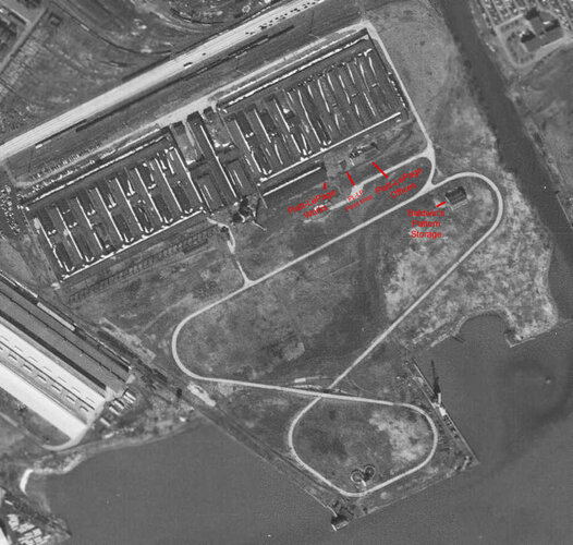

Platt-LePage and Rheem worked together on several projects, related to the helicopters, and helicopter components, as well as using Platt-LePage engineering staff on non aviation military projects.
Some may not be aware, but Platt-LePage Aircraft was located on the Baldwin Locomotive Works facilities, the area which was located quite literally adjacent to the Delaware river. (As was one of the major suppliers of specialty airframe components for the XR-1 & XR-1A, and YR-1A)
This made Platt-LePage a valuable subcontractor for Rheem's non aviation military contracts during WW-2, with the availability of Baldwin's heavy production facilities.
This became a factor in causing the shut down of Platt-LePage postwar, when they were locked out of their facilities during a steel workers union strike in 1946.
