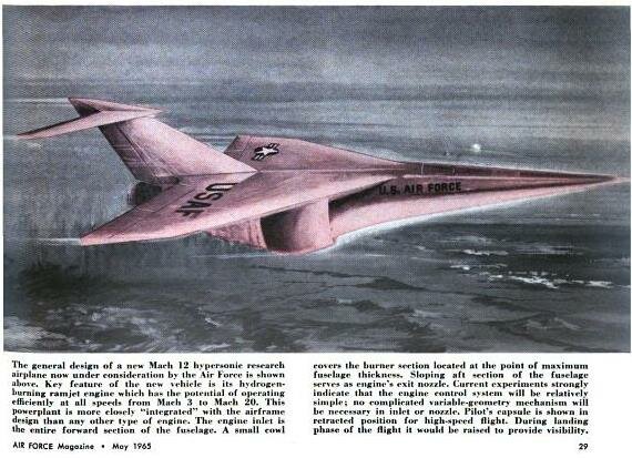

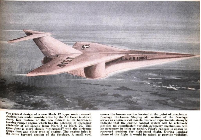

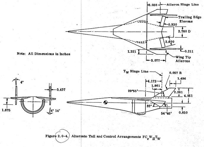

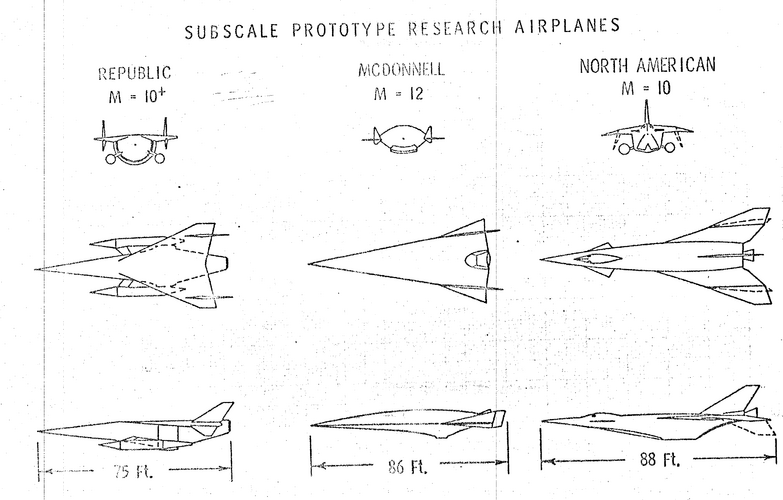

From Air Force 1965,
what was this ?.
Found in May 1965 issue of Air Force Magazine, Vol. 48 article
Hypersonic Aircraft:
Possible and Practical
By J. S. Butz, Jr.

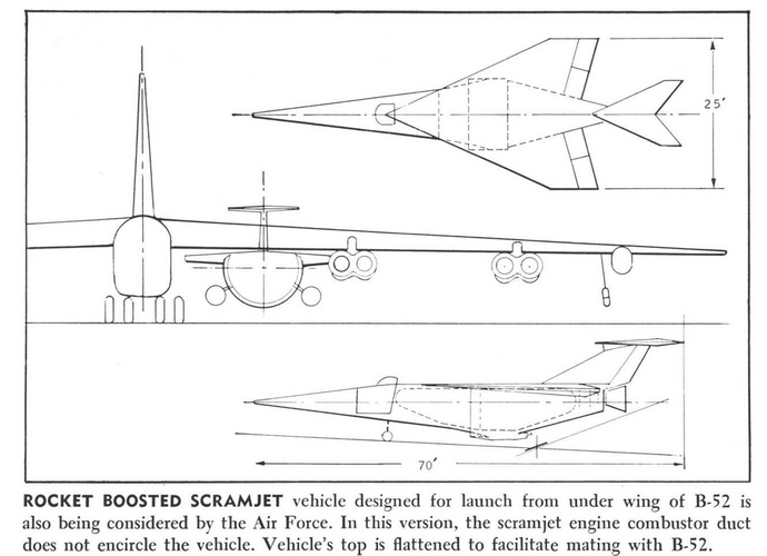

The Mach 12 experimental aircraft would make use of many proven X-15 techniques. It would be approximately the same size as the X-15, fifty feet long with twenty-two-foot span and 50,000-pound gross weight, and would be air-launched. Either a B-52 or a B-70 could serve as the mother aircraft. If the B-52 is used it will be necessary to provide the hypersonic aircraft with a controllable hydrogen-oxygen rocket and jettisonable oxygen tanks to accelerate to Mach 3.
After Mach speed is attained it will be possible to start the hydrogen-fueled supersonic-combustion ram-jet. This engine extends the entire length of the aircraft. The long forward section of the fuselage doubles as the fixed-geometry engine air inlet. The shock wave pattern off of the forward fuselage slows the air entering the burner down to supersonic speeds.
A small cowl located at the point of maximum fuselage thickness encloses the burner area. The sloping aft fuselage section is the fixed-geometry nozzle.
This design is a slightly modified form of the ideal fixed-geometry configuration for a hypersonic air-breathing engine. Ideally, the fuselage would be circular and the engine would extend around its complete circumference. However, to carry the experimental aircraft under another airplane it will be necessary to flatten its upper portion and limit the engine to its lower sections."​

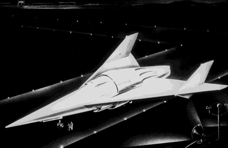

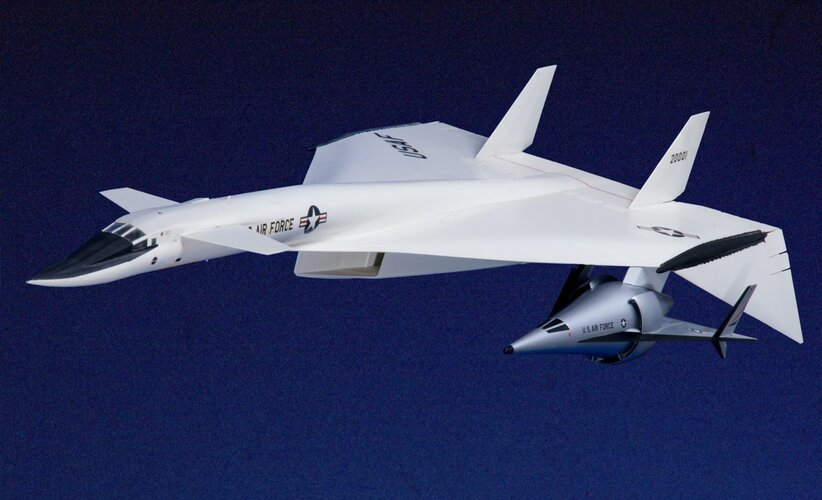

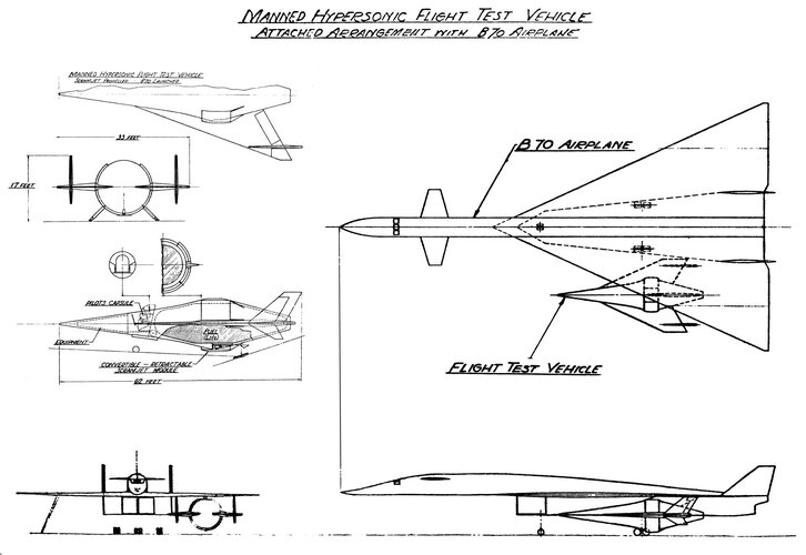

I wonder if it's related to the "Manned Hypersonic Flight Test Vehicle" as shown in the AFMC "NAA B-70 VALKYRIE VARIANTS" pdf ?
I didn't find mention of it before here (or an especially pertinent thread to add to), but if I've missed please move to relevant thread

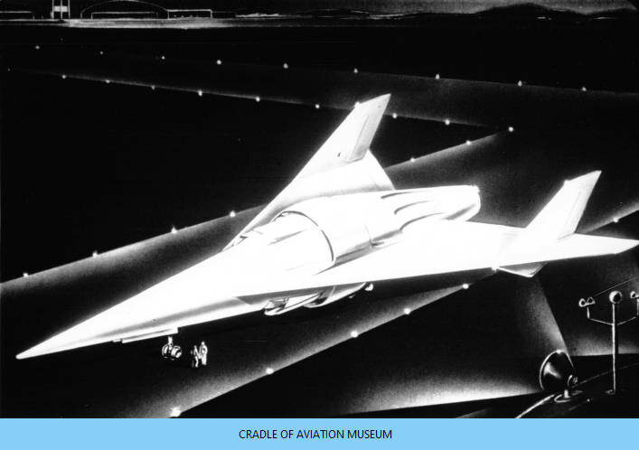

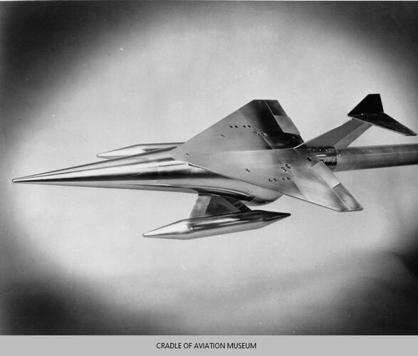

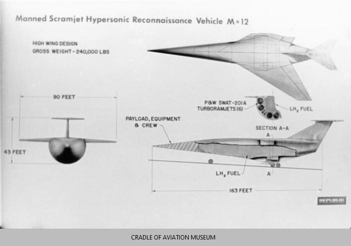

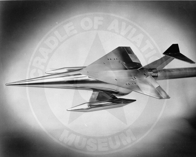

Not so 'generic'. Proposed Republic Aerospaceplane demonstrator.
Ah! Surely that's the one in the B-70 Landis pdf - I can't seem to find a swept T-tail variant like this one without the verticals in the wings but the article does mention the flattening of the upper fuselage.

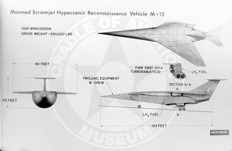

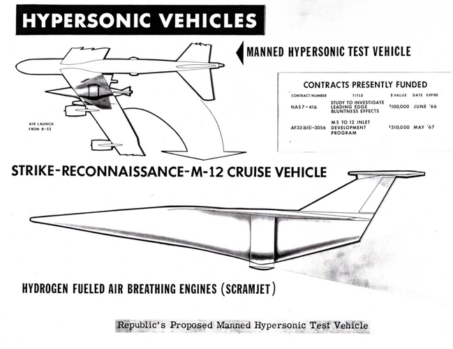

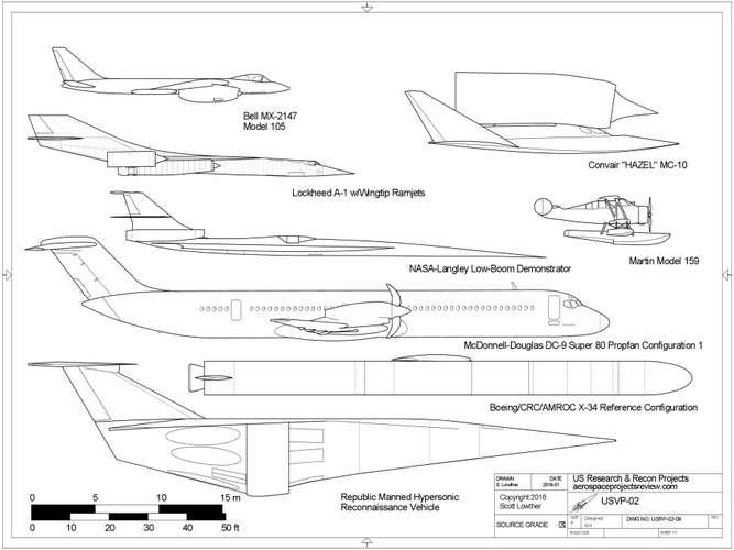

Well... it's one of the competing designs for the "Manned Hypersonic Test Vehicle" program, which included North American and McDonnell. It used the same *shape* as one of the Republic/Kartvelli ASP concepts, but some years after ASP had died. Republic kept recycling the basic shape for a number of years; it appeared in somewhat modified form in the NAPS days. The NAA MHTV was discussed here:
https://www.secretprojects.co.uk/threads/naa-mhtv-3-manned-hypersonic-test-vehicle-x-15d.4763/
I stand corrected. And yes - this is actually post-Aerospaceplane (ca.1965) demostrator _based_ on Aerospaceplane design, for a Mach 12 Recon vehicle.
