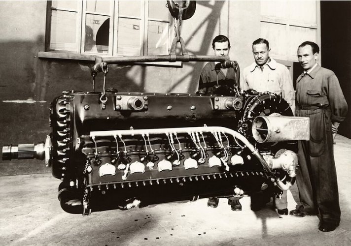

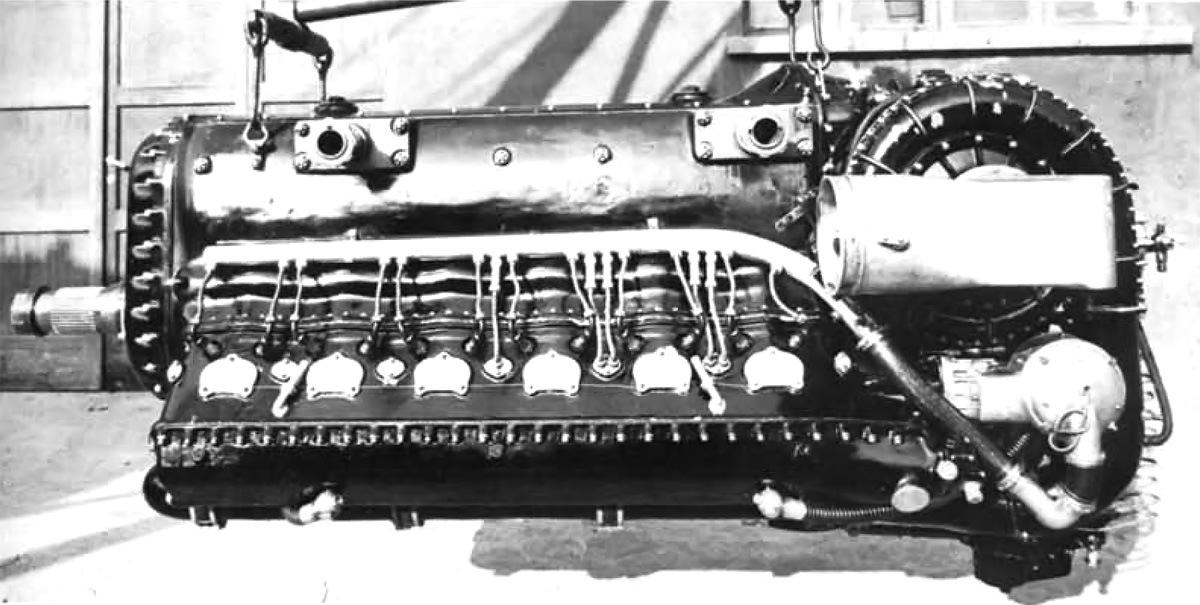

A picture of the Re 103 (Can't copy unfortunately):
