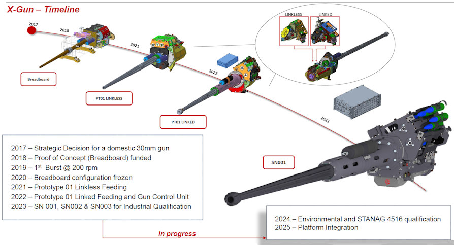

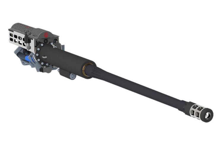

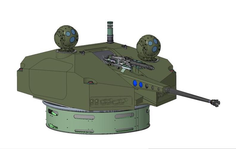

Announced in 2023, the X-Gun is an electrically powered single-barrel 30x173 gun for both land and naval applications:
More technical details here: https://www.edrmagazine.eu/leonardo-details-its-30-mm-x-gun-and-announces-first-two-customers

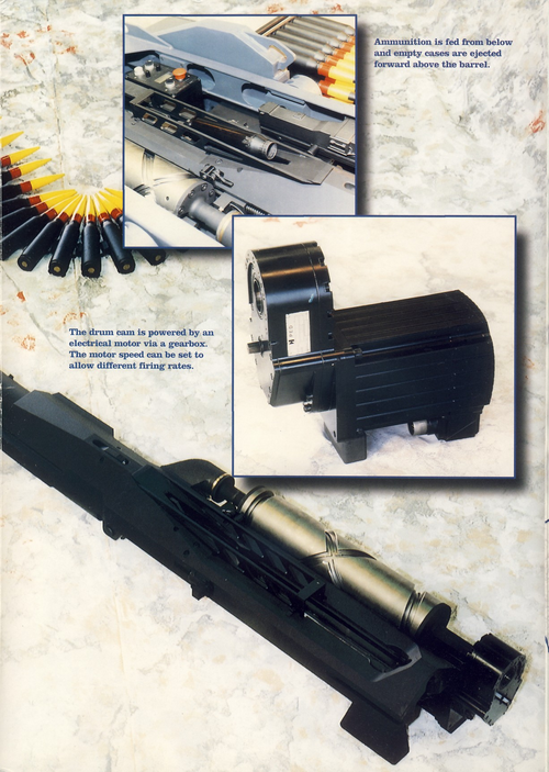

The mechanism looks interesting, being driven by a single rotating drum with cam slots, which makes it rather simple mechanically and easy to control for things like single shots or controlled RoF. (They talk about a "sniper" mode, where it chambers a round then stops, waiting for a full trigger press to fire the round).
Overall mass: 173 kg (78 kg for the receiver, 60 kg for the barrel, and 35 kg for the feeder) plus 16 kg for the Gun Control Unit.
Dimensions: 3,555 mm long (breech block is 431 mm wide and 465 mm high, barrel is 2700 mm long)
C-UAS is one of the gun's intended roles, and so it is set up for induction fuzing of ABM rounds from the outset, with built-in Mv detection in the muzzle brake.
Looks like there are a couple of naval applications already, one for the Italian Navy and one for Canada, so perhaps this doesn't belong in Projects, but they say it is still technically TRL 6.

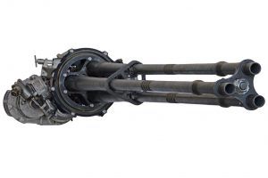

Up next is the Gatling 20, which looks to be basically an ITAR-free equivalent to the TM197, a 3-barrel Gatling firing 20mmx102 ammo.
