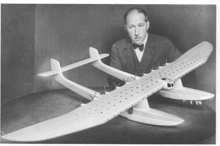

It doubt if it was ever built. Many companies proposed twin-Bull flying boats but few ever got beyond tow tank testing. I remember a video of a model getting violently unstable in a tow tank.

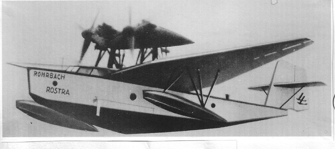

a Rumpler 1927 and a Rohrbach 1928 ....
Gotta love those German names. Crumpler doesn't sound all too appropriate a name for an aircraft, imagine if it crumples in flight. As for Rohrbach - reminds me of the psychotic vigilante from Watchmen (named after the ink blot test used by shrinks).
So far I know , it's not a Rohrbach : for me , it could be related with a Rumpler ...

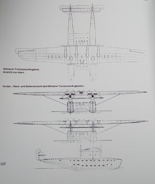

The drawings are from 'Die Deutschen Flugboote'. Apparently the design dated from 1925 but funds could not be raised in Germany to build it. There was a proposal in 1930 to construct it in USA, but the fallout from the financial crash ended any further plans.
You're probably right but there is the D-1928 designation on the wing and hull, and that looks real? The "article" could be false, but the plane real?
D-1928 was indeed a real registration in the old German numbered system. But D-1928 was first assigned to a 1930 BFW M.20b airliner (wk.nr. 442, 'Rheinpfalz' of DLH) which crashed 14 April 1931.
I suspect that the 'D-1928' on your illustration was simply an artistic reference to an anticipated date of service.
