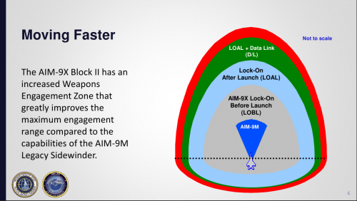

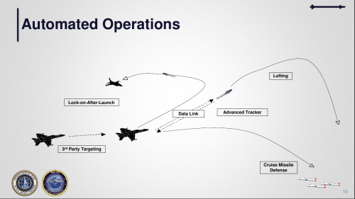

From 42nd Air Armament Symposium
Sponsored by NDIA Gulf Coast Chapter

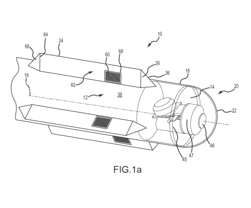

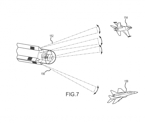

Interesting recent patent from Raytheon published last year -
ADAPTIVE ELECTRONICALLY STEERABLE
ARRAY (AESA)SYSTEM FOR INTERCEPTOR RF TARGET ENGAGEMENT AND COMMUNICATIONS
* Please feel free to move it to a different threat if one is more appropriate
  • RaytheonSERV34_2016.pdf
Interesting find bring_it_on, is the missile seeker patent part of a Sidewinder replacement program or something else?

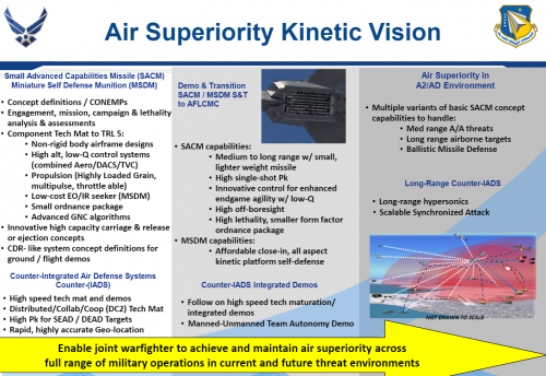

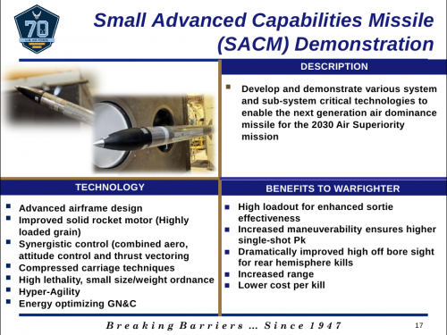

From the Blackhurst AFRL presentation at SET 2017
Do you have the rest of the report this was attached to? Thanks

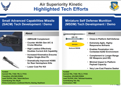

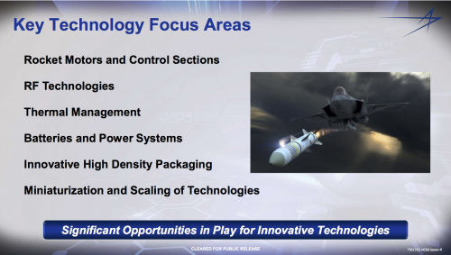

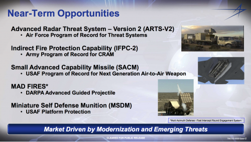

Lockheed 2017 Supplier Conference
I hope that second picture means LM hasn't given up on CUDA. That would appear to be just what is needed. (And maybe a 2-stage variant, the same OA length as AIM-120, for long range shots.)
hmm still tail control ? I thought they will move to canard control to maximize room for rocket motor, like Python.
They haven't. They have publicly spoken about it being an ongoing internal project. From earlier this year -
CUDA is at an earlier stage of development, but it is coming along "really well", Cahill noted. "It is defined, modelled, and we are now working hard on the prototype airframes and on the seeker concepts," he said. As the threats become more complex, Cahill added, having highly manoeuvrable hit-to-kill systems in a smaller profile will prove particularly valuable, especially at close range.
"All of our hit-to-kill developments leverage the basic PAC-3 technology and capability - that combination of seeker technology, advanced attitude control systems, and robust airframe that can turn on a dime and follow a rapidly manoeuvering target - and optimise that combination in a smaller profile," Cahill explained. "With CUDA, you're talking about a PAC-3 capability with a front-end sensor the size of a coffee cup; with MHTK it's even smaller. So we're essentially taking the PAC-3 capability and miniaturising it across all of this range of interceptors."
""With CUDA, you're talking about a PAC-3 capability with a front-end sensor the size of a coffee cup; with MHTK it's even smaller. So we're essentially taking the PAC-3 capability and miniaturising it across all of this range of interceptors."

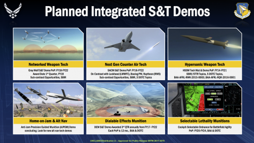

Do you have the full presentation for those two slides?
