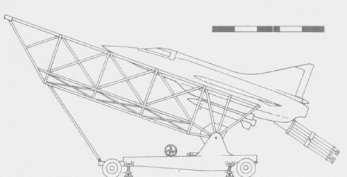

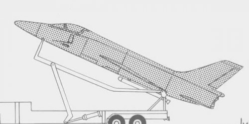

Can anybody tell me, where I can find types and data of NATO RATOG ?
Especially, of course, those which were used by the french AdlA ?
And another question : Are the booster rockets shown in the drawings of the
SE 212C and Be.1005 standard types ?
(Both drawings from J.Cuny, "Les Avions De Combat Francais")

Dear Jemiba
I read on an old "Le Fana de l'aviation ":
A baterry of five STRIM boosters (18750 kg/p during 2seconds)
could be able to launch the the SE 212 C From an oblic ramp
as the SE 4200
2 supports with rails of 12 meters long with inclination of 20 °
