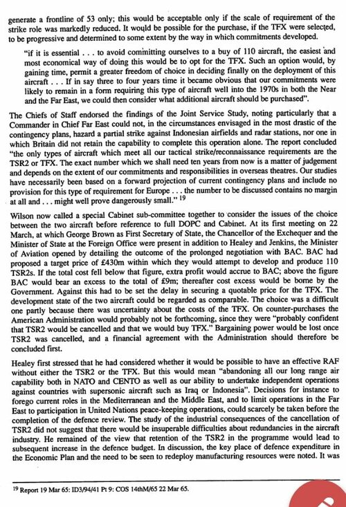

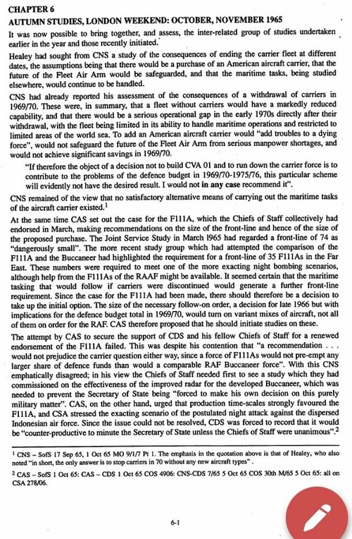

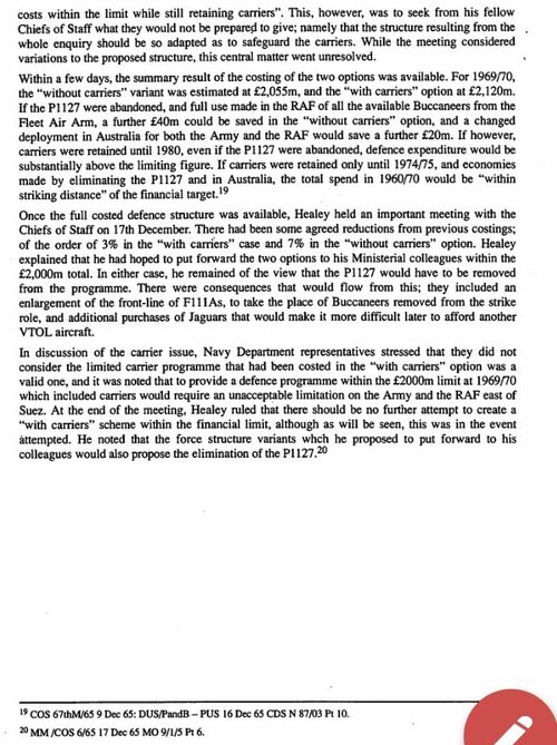

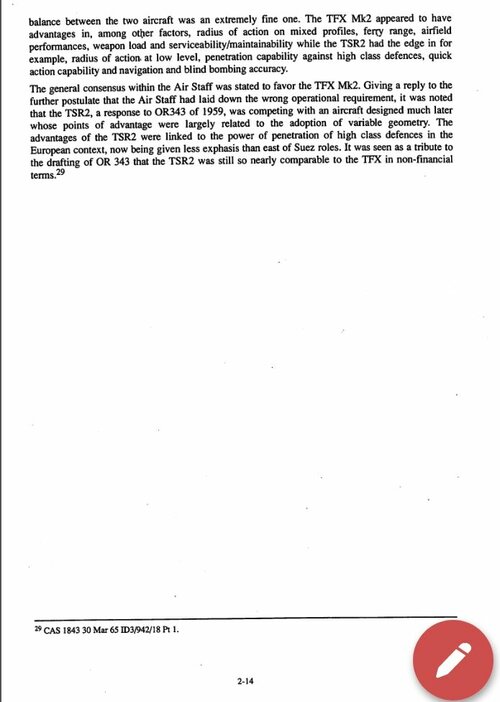

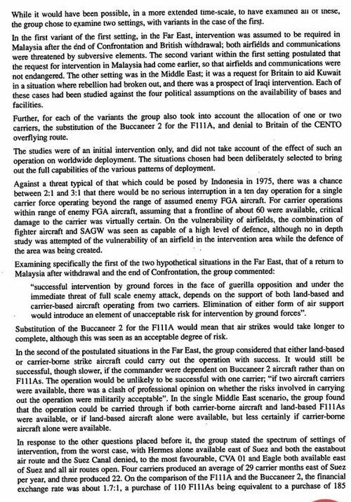

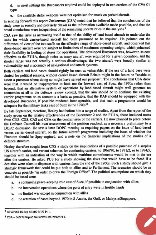

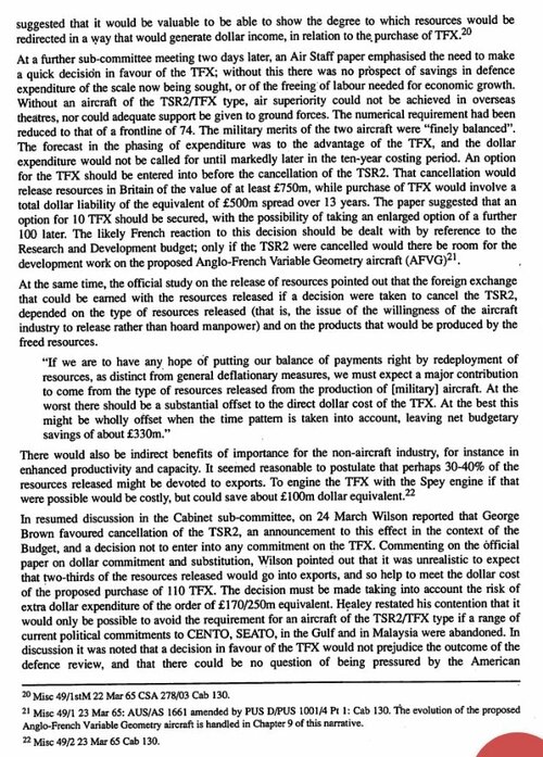

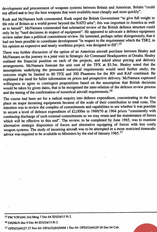

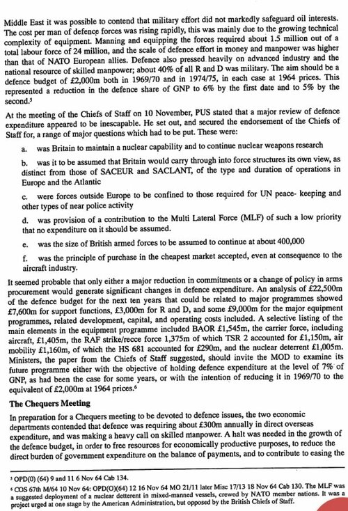

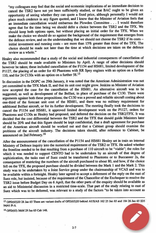

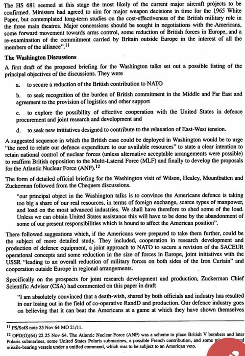

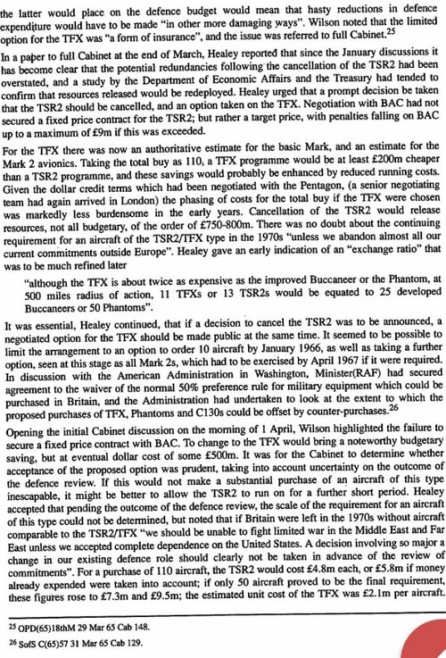

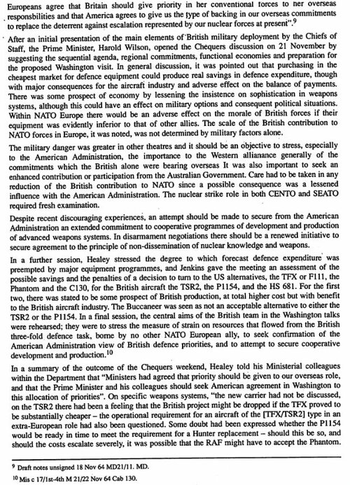

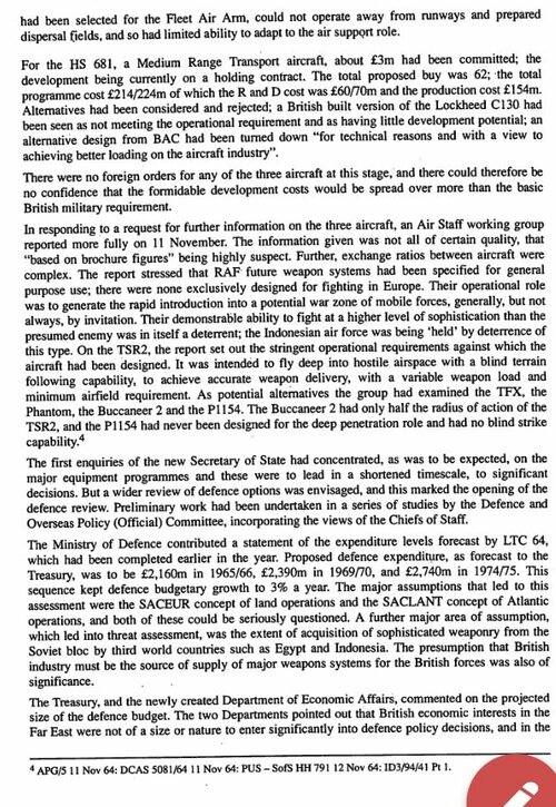

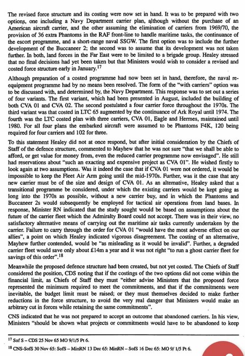

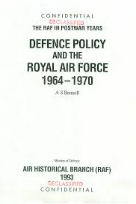

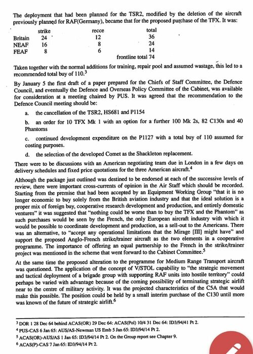

I have found a declassified RAF document giving the most detailed account of the TSR2, P1154, and HS681 cancellations.
  • AIR 41-94 Defence Policy and the RAF 1964-1977.pdf

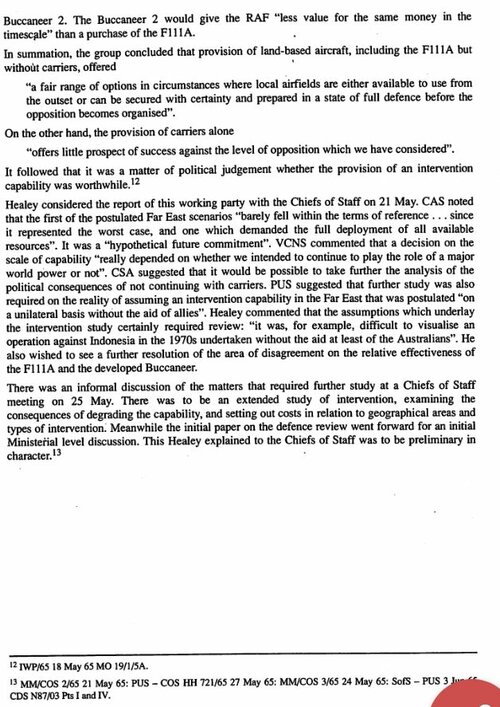

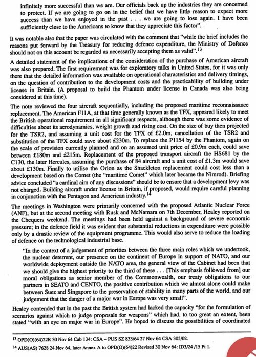

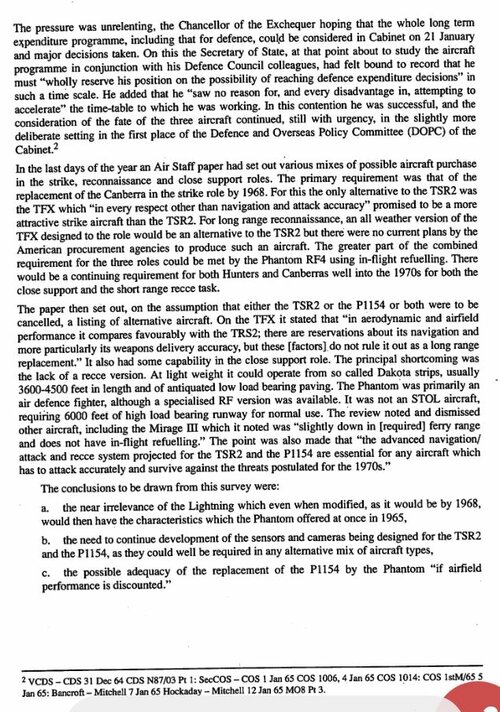

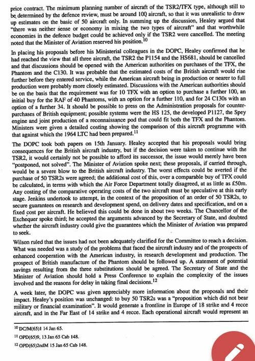

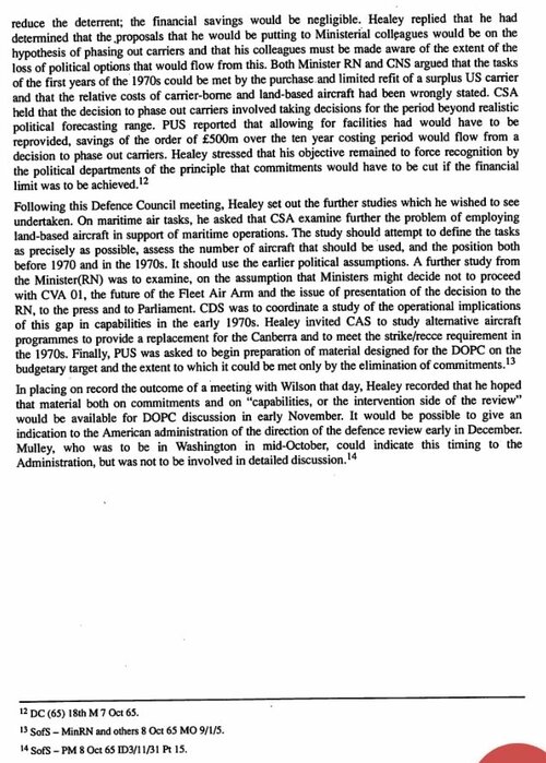

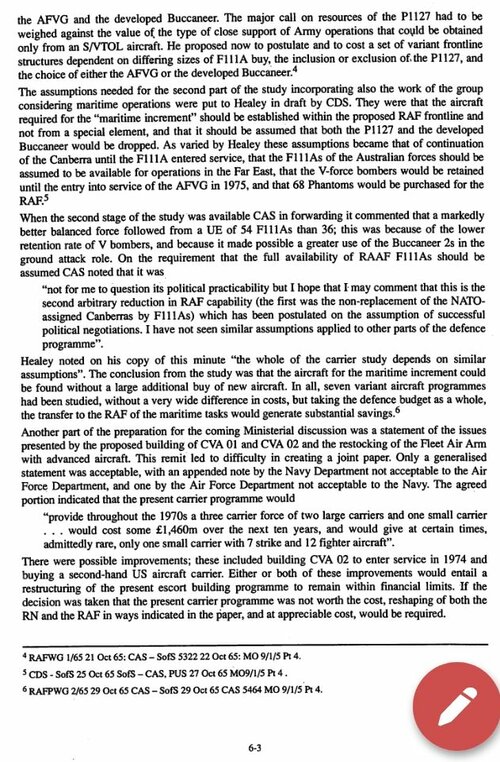

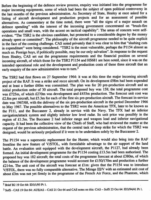

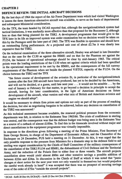

Because good things have a habit of vanishing I have screensaved key bits.
First 14 are about the lead up to cancellation of 1154 and 681.

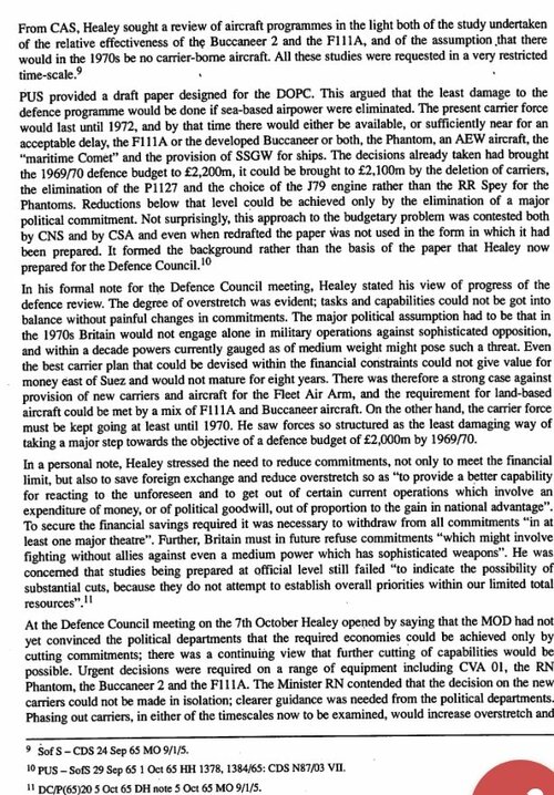

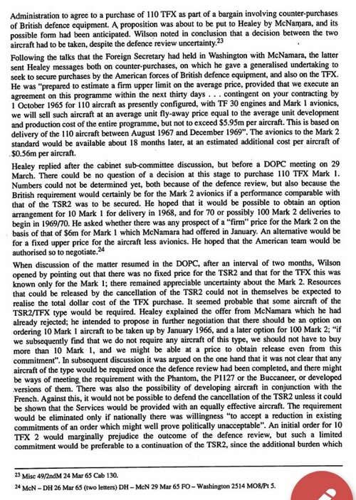

Now we have the process that selected F111 over TSR2. This should generate some interesting discussions as it was a close run thing.

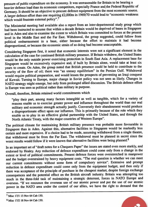

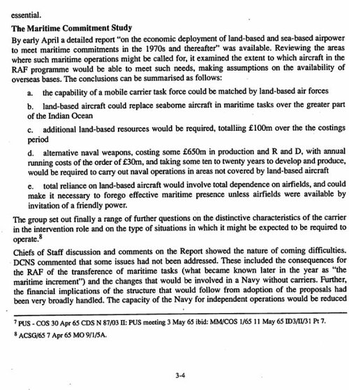

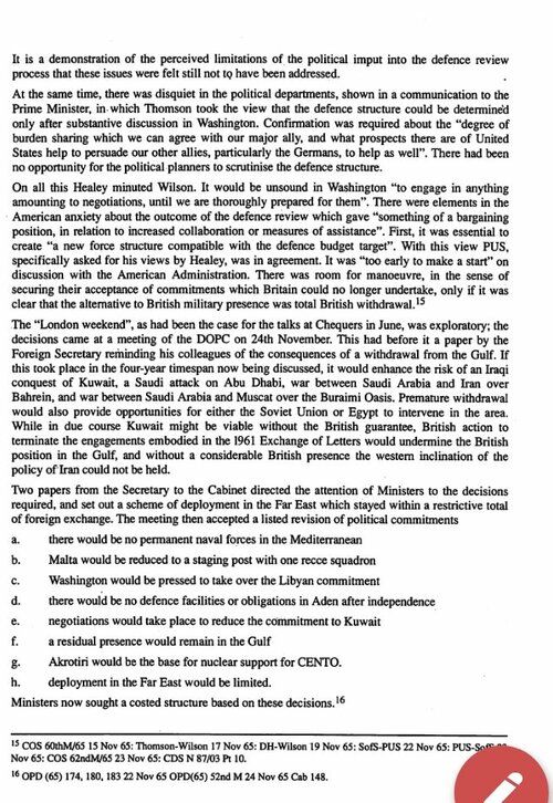

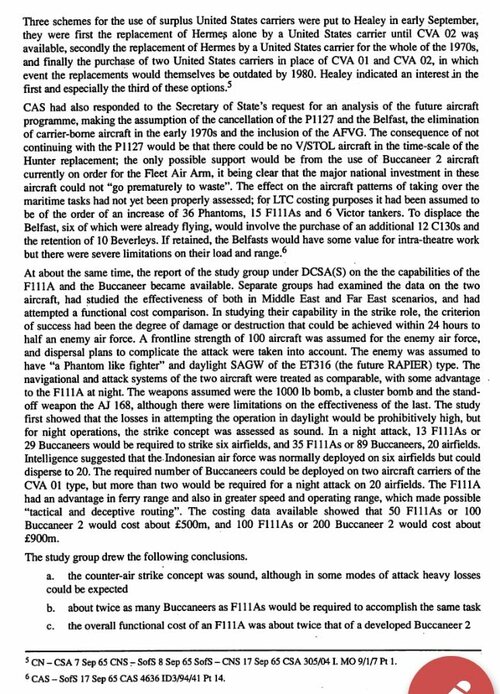

Having decided on F111s the next argument is over land based versus carrier air power. NATO Vs USSR does not feature

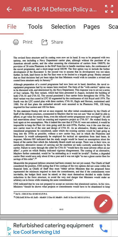

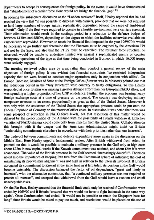

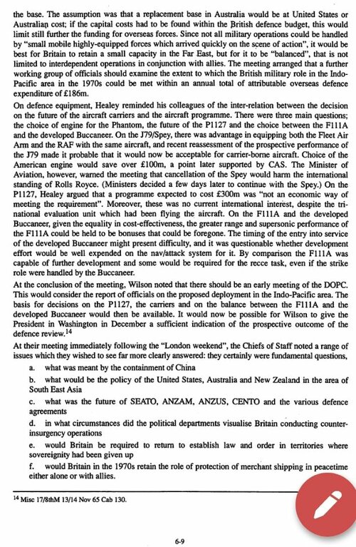

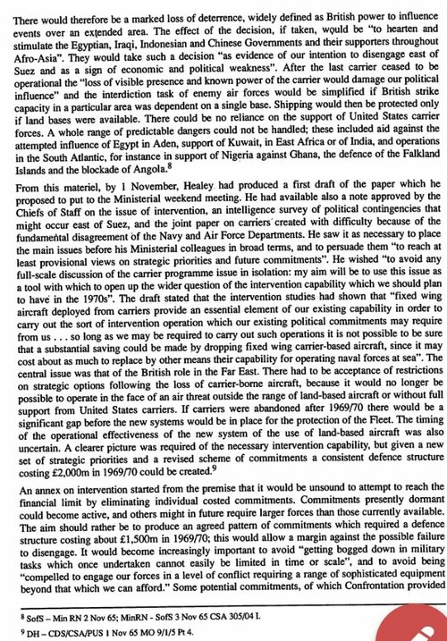

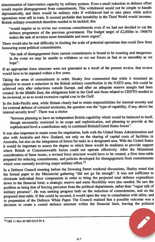

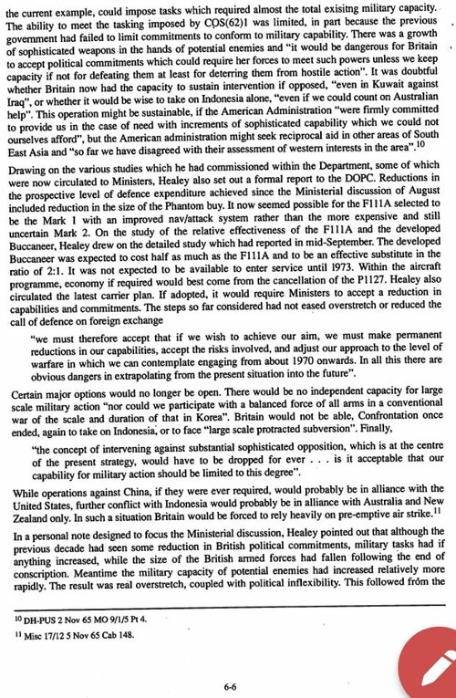

The gloves are off in the next stage with not just the RN but also the RAF challenged to find cuts and a clear intention to wind down East of Suez.

Folks might find AIR 41/85 equally interesting.
Both AIR 41/85 and AIR 41/94 are Air Historical Branch papers.
  • AIR 41-85 The Bomber Role 1945-1970.pdf

According to the TNA catalogue, AIR 41/94 was opened on 2 May 2018 - so the standard 25 year release.
AIR 41/85 was not classified at all.
I'm not sure that classification was anything to do with preventing diplomatic blushes as most of the F-111K files were released on 1 January 1999 - only 6 years after the AHB paper was written.

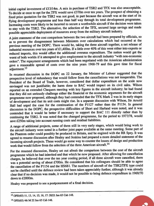

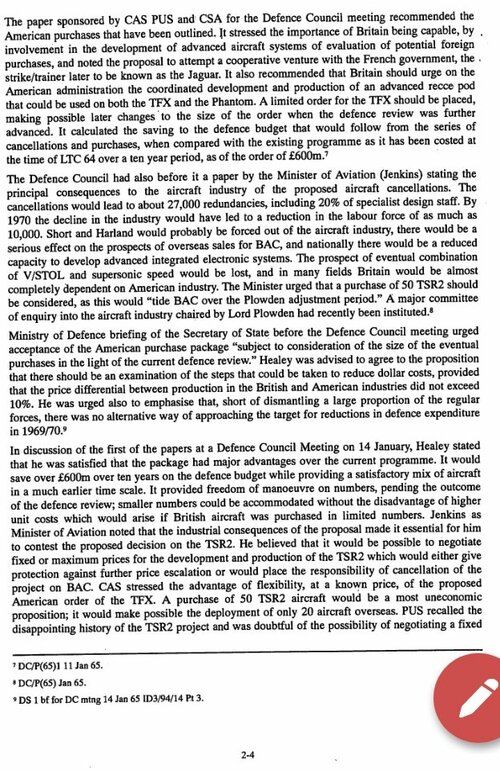

P.1154 £1 million verses F4 £0.9 million.
TSR.2 £2.8 million verses TFX £1.5 to £2 million.
HS.681 £3 million verses C-13 £1.3 million.
Just shows they had no inkling of the scale of cost increases that would come.
TSR.2 noted as superior in low level radius of action, blind bombing, penetration of defences and quick action capability. Advantage to TSR.2 in European Theatre against the high density defences there. Less justified against lower capability in other theatres.
Immediately hits home is the near magical thinking on F111A and absence of understanding carrier airpower.....frankly I suspect a lack of proper appreciation of naval power...or indeed the perspective of high level Military.
