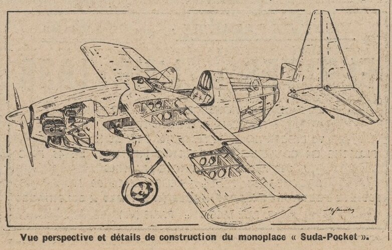

Later in 1938 or 1939, [1] Gaucher established a workshop at Jurançon in SW France. [2] His goal was to build demonstrator prototypes to promote plans sales to amateur-builders for a new lightplane. The unrealized design was called Suda-Pocket based on his workshop name - Sud Aviation (I hope that Gaucher trademarked that name!). Four 'Sud' designs were being constructed when WW2 brought work to an end. [3]

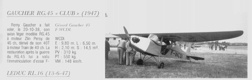

In the immediate postwar period, Gaucher established Plénair-Aviation to develop a Zlin Persey-powered prototype of the P.A.47 (then often just referred to as the 'Plénair'. Plénair-Aviation was probably also intended to develop the Week-End 48 derivative (possibly designated 'P.A.48'). The Week-End 48 wasn't built and the lower-powered P.A.47 would be built by Roland Payen's firm, Société Aéro-Routière de la Loire, as the Pa.47 Weekend. Plénair-Aviation then disappears. After that, Rémy Gaucher seems to have operated strictly as a freelance aircraft designer (and occasional collaborator with others).
