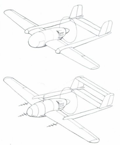

I've just found further info on the SWS Upiór (the name could be translated as Phantom or Ghost). My theory that LWD Miś was to be used rather as a test-vehicle for reconnaissance/surveillance equipement than a pilotless airplane that was to became Upiór. There was also an idea to use CSS-12 light passenger/transport aircraft for such a purpose.
SWS Upiór itself was to be a pilotless aircraft with ex-German Argus As-410 or As-411 whose role was that of TV (and perhaps IR) reconnaissance of battlefield. Here you've got drawings made by a contemporary artist based upon original notes and hand sketches that survived to this time.
