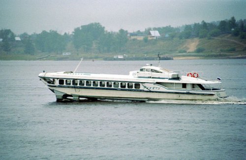

During the fifties, the Soviet Unions's Krasnoye Sormovo shipyard started production of hydrofoil ferries. Chief designer Rostislav Alexeyev, who later worked on Ekranoplans.
1957-1970s: Raketa, exported to Austria, Cambodia, Finland, Germany, Poland, Lithuania, etc.

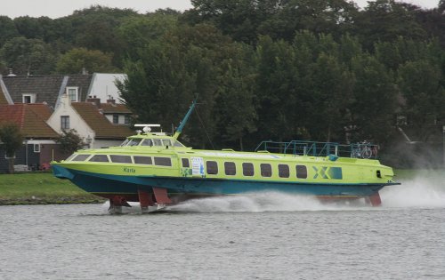

1973-onwards: Voskhod, exported to, among other countries, the Netherlands. I once visited Amsterdam with my mum and one of my brothers, making the round trip from IJmuiden where mum used to live. The first image, from Wiki, shows the Amsterdam ferry.
The second Wiki-image shows Raketa 234 on the Volga River, 2004
