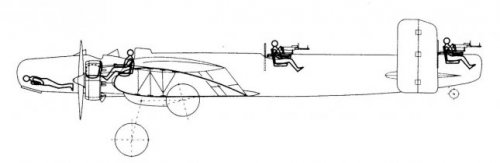

PZL-30 - 1936 PZL production vers. of LWS-6 Żubr (Wisent) medium bomber
- PZL-30BI : Prototype Żubr (devel. LWS-6), aka PZL-30B/I
- PZL-30BII: Modified prototype PZL-30BI, aka PZL-30B/II
- PZL-30B : 4-seat twin-engine high-wing monoplane, x 16
- PZL-30[?]: Proposed Romanian vers. with GR 14K radials
-- http://www.secretprojects.co.uk/forum/index.php/topic,12050.msg117324.html#msg117324
-- http://www.secretprojects.co.uk/forum/index.php/topic,12050.msg117399.html#msg117399
