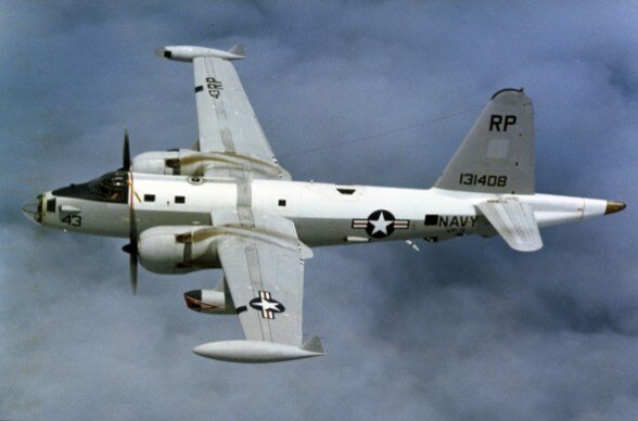

The idea of mixing powerplants (for maritime patrol aircrafts included, the P2 Neptune illustrated for example) is not a novelty.
The only modern purposed built maritime patrol aircraft I can think of is the Japanese Kawasaki P-1. It is motorised by four high bypass turbofans especially developed for it.
