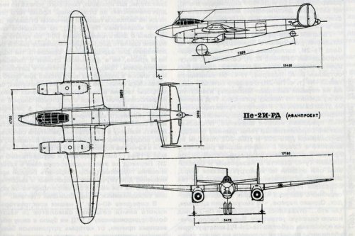

The News from "east front". In 1945 in OKB Kazan factory №22 headed by V.MYASISCHEV's were winnowed work on making the jet midwing plane on base Pe-2 I.
Year :1945 Februar
engine :2xJumo 004
max speed :700 km/h (800 km/h an altitude of 5km)
service ceiling:11000m
range: 1550km
armament :1x20mm ShVAK + 1x12,7mm/1500kg bombs
altern. fighter :2x20mm or 2x37mm
weights :loaded 9450kg (max 10400kg)
empty 5450kg
(Авиация - Космонавтика №19 1996)
