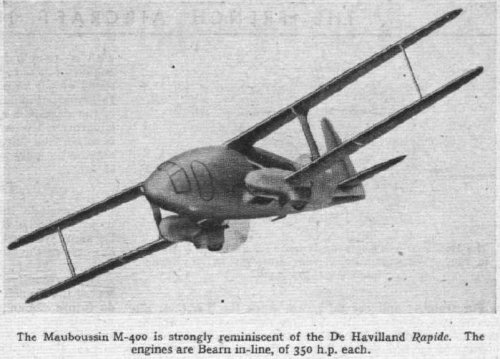

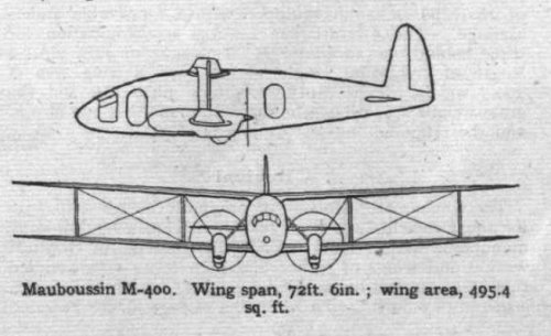

the Mauboussin M.400 was twin engined light tyransport biplane
project,powered by two 350 hp Bearn C.M.B-6D inline engines
and had estimated speed of 225 mph.
http://www.flightglobal.com/PDFArchive/View/1943/1943%20-%202361.html
When was this project from hesham?
Its an interesting blend of streamlining and typical biplane.
In "Planeurs & Avions" by Christian Castello it is said to be a development
from 1939, so the date of publishing in Flight can be a little misleading
1939 is correct.It was the last design of Mauboussin.
Mauboussin M 400- Biplan a grand allongement et moteurs propulsifs.
engines : 2BE 6 DO of 350hp.
span : 22.10m
lenght : 15.00m
height : 4.01m
empty weight :2604kg
crew+passenger :3
range :100km.
Error.
Range must be : 1000km.
source: L'Aviation-early sixties.

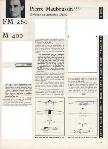

Dear Hesham, here is an article I've found in French on the Mauboussin M 400 biplane project along with the Mauboussin FM 260 project; neither of which are "secret". I've edited out material on the Mauboussin M 300 which was built and flown......
The article comes from the 15th September 1967 issue of Aviation Magazine International......
Terry (Caravellarella)

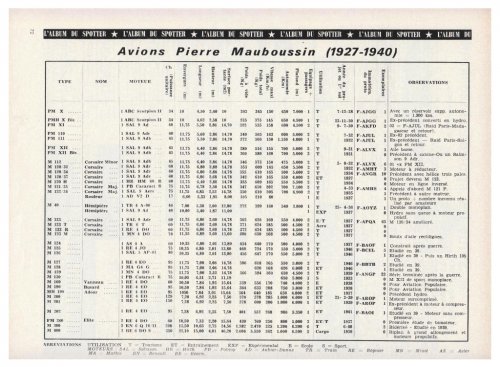

Poor Hesham; don't worry. This list might help; it's from the same article but I didn't originally include it as many aren't "projects"......
Best, Terry (Caravellarella)
  • Avions Pierre Mauboussin - Aviation Magazine International - No. 475 - 15th Septembre 1967.......jpg
Thank you my dear Caravellarella,
and I know those Mauboussin aircraft,except M.130 and FM.260.

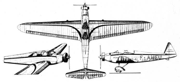

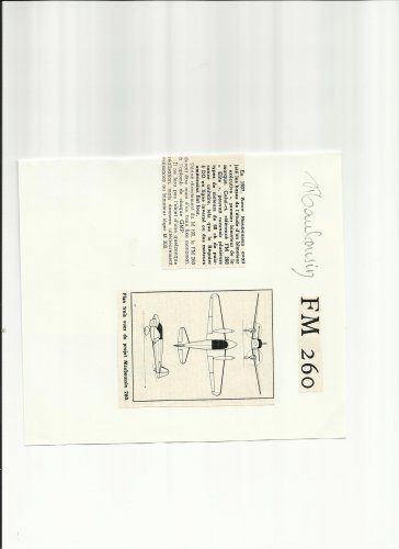

Hi Hesham
Maubousin fm 260

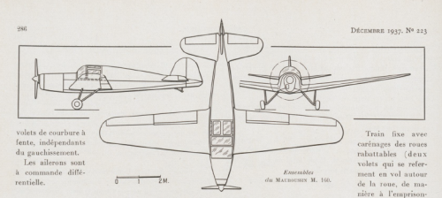

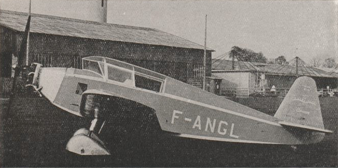

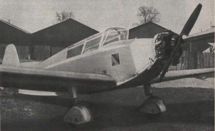

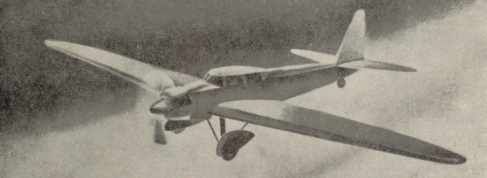

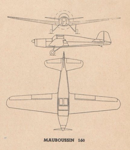

From l'Aeronautique 12/1937,here is the Mauboussin M.160 side-by-side two seat
trainer aircraft project.

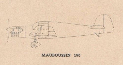

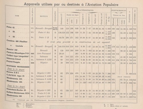

Mauboussin 160 and 190 for l'Aviation Populaire, from L'Aérophile 02/1938.
The two aircraft look closely related.
