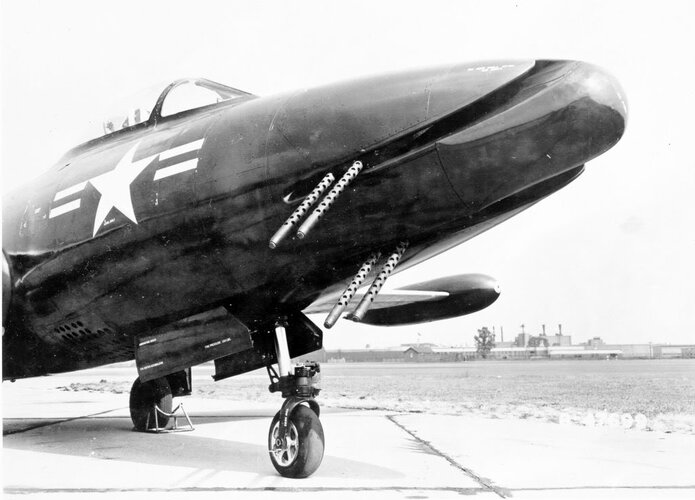

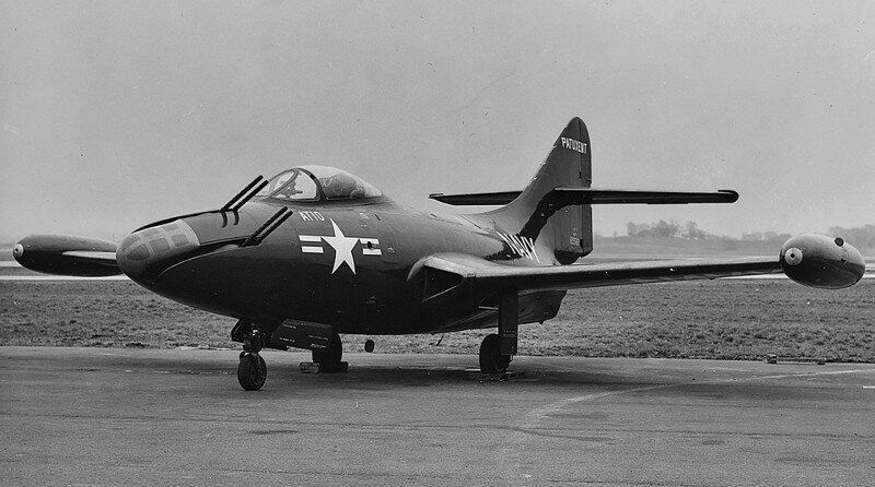

In his auto-biography, Grumman test-pilot Corky Meyers briefly mentions a similar experiment with fitting 4 swiveling .50 calibre machineguns in the nose of a Panther jet fighter. Since none of the Grumman test-pilots could figure out how to aim the cannons, the project was soon dropped.
In his auto-biography, Grumman test-pilot Corky Meyers briefly mentions a similar experiment with fitting swiveling cannons in the nose of a Panther jet fighter. Since none of the Grumman test-pilots could figure out how to aim the cannons, the project was soon dropped.
Yes I've seen photos: there was a similar F-89 fit but the Grumman project wasn't part of Gun-Val.

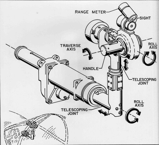

It was a Panther with an Emerson turret with four .50 guns, it was a sort of "all-around" Schraege Musik :D
Here the description from Wikipedia:
A U.S. Navy Grumman F9F-3 Panther (BuNo 122562) operated by the Naval Air Test Center at Patuxent River, Maryland (USA). This aircraft was fitted with an experimental electro-hydraulically driven Emerson Aero X17A roll-traverse turret housing four 12.7 mm machine guns, in 1950. The idea was that the aircraft could destroy enemy bombers while avoiding the fire of the tail gunner. The guns could be directed at any angle from directly forward to 20 degrees aft, and the gun mount could roll 360 degrees. The roll rate was 100 degrees per second, and the guns could be traversed at up to 200 degrees per second. Unfortunately, the volume required for the fire control system avionics, and the sheer weight of the turret, made it impractical for single-seat fighters and the program was cancelled in early 1954.
Panther with Emerson nose turret
I know, it is Wikipedia, but the original link to the Naval Aviation Museun does not work, and the Museum website says "we are upgrading our popular feature that allows online visitors to search the museum’s database".
The Panther wasn't one of the Gun-Val aircraft though. However I do think we may have a winner with the F-84F/M24 combination. I'd also suspect it would possibly pass by without much of a second look.

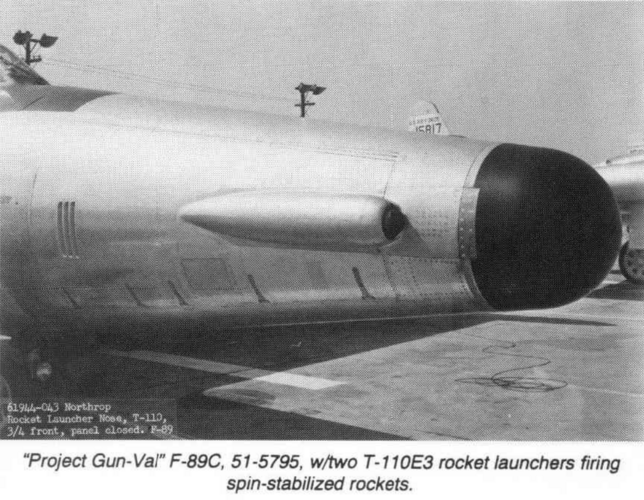

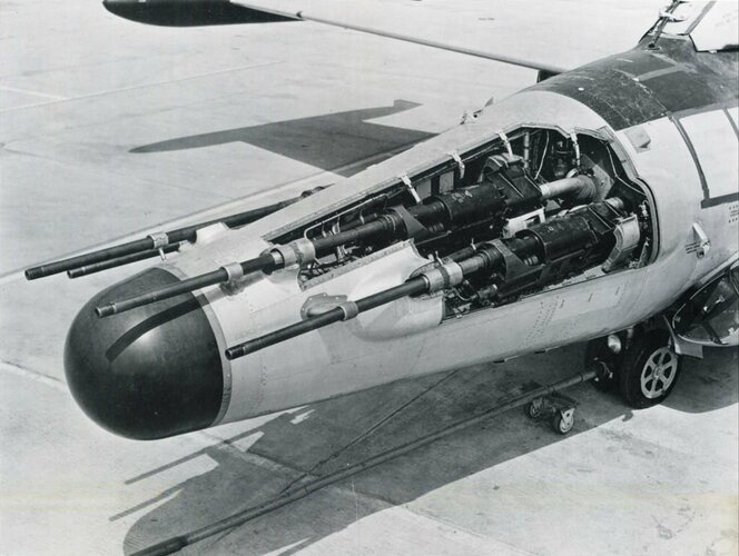

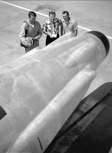

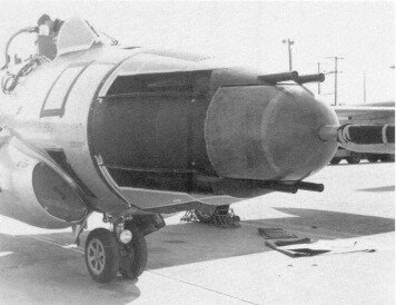

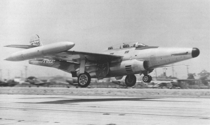

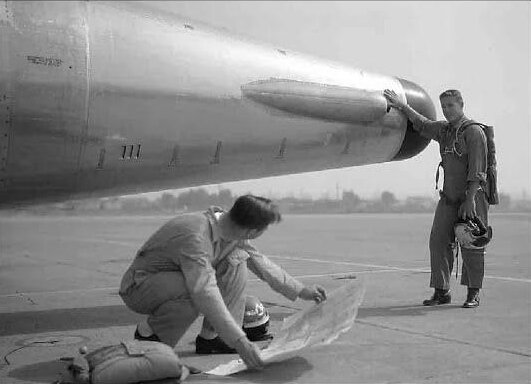

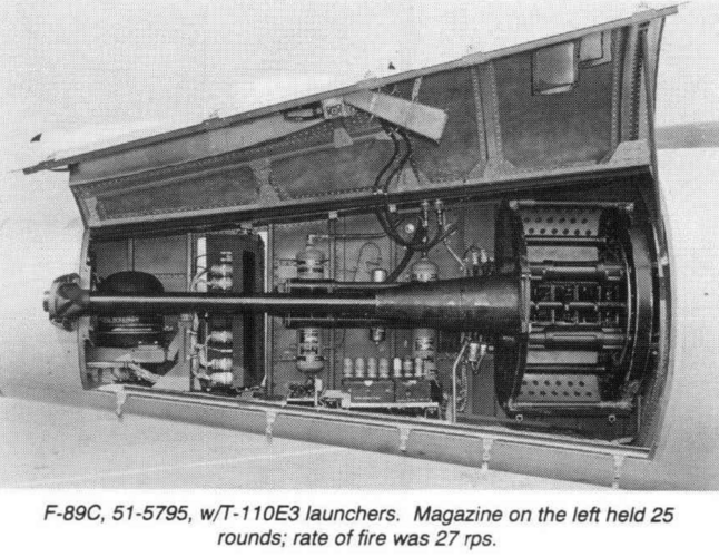

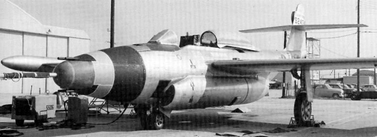

GUNVAL evaluated the gun-like T-110 rocket launcher, 4 x 30-mm Oerlikon 302RK cannon, and a Martin D-1 nose turret with 4 x 20-mm (?) guns:

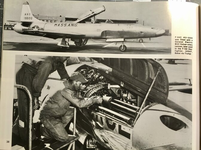

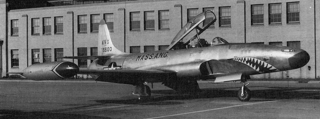

The F-94 was also evaluated during GUNVAL with a 20-mm Vulcan gun:

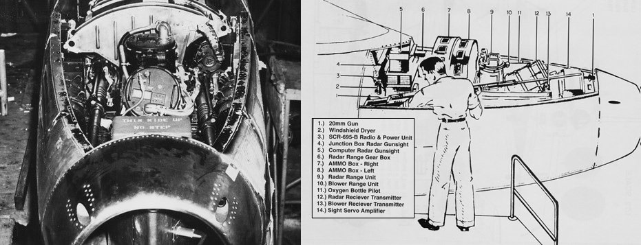

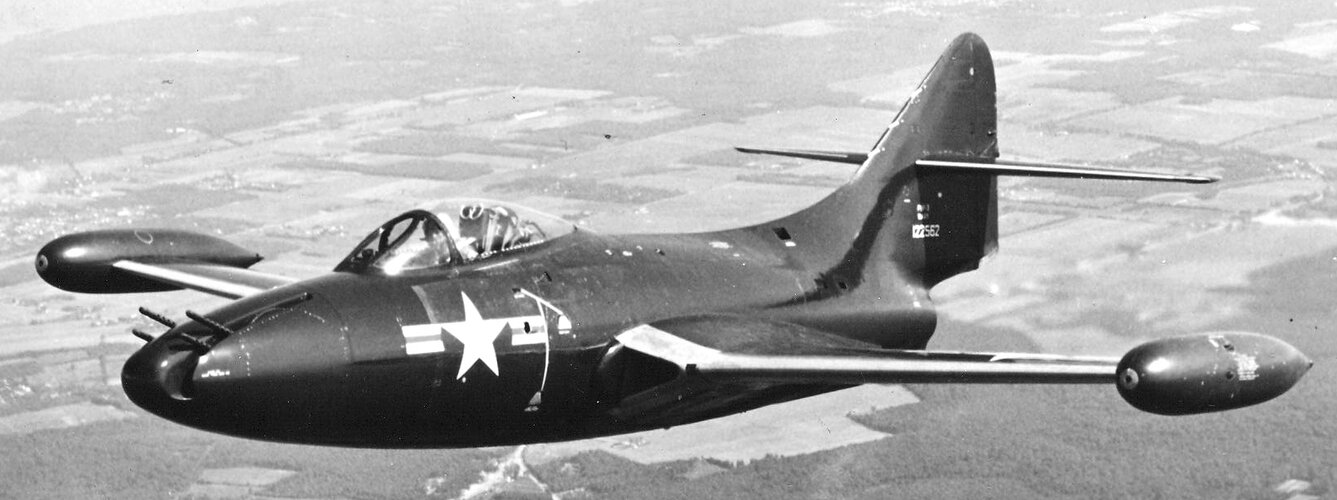

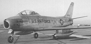

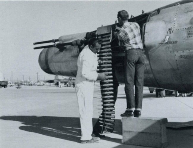

Two F-86F-3 Sabres received 4 x 20-mm Oerlikon 206RK cannon instead of the 4 x T-160 (M-39) guns used on the F-86F-2s:
