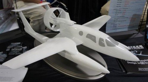

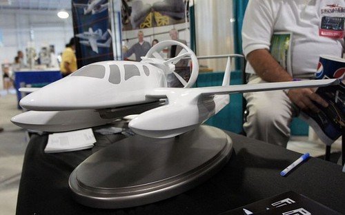

It's a pretty model, but it looks like the ducted propeller would get a lot of spray, maybe even green water (a nautical term for solid water, rather than spray/foam washing over a weather deck). Back in the seaplane era, it seemed spray was impossible to model reliably and acceptable results in this area were often obtained only after numerous modifications to prototypes. I doubt that water-tank testing has improved that much in the intervening years or that anyone has put the effort into developing CFD software to handle a waterborne seaplane. It makes me wonder whether this is a serious project - it must have occurred to the designers that the airscrew looks well placed to serve as a sprayscrew (I just copyrighted this word) and I doubt that the tools exist to demonstrate otherwise. Maybe you show a pretty model to investors and then build the prototype with the propeller in a less appealing but drier location.
I also question the rearward extent of the tailboom/floats. I can't think of any floatplane floats or seaplane planing hulls that extend that far aft. Generally a seaplane's fuselage sweeps upwards so that the after fuselage can descend into the trough behind the planing surface without dragging in the water during rotation.
The Privateer looks like it might have been unable to rotate.
